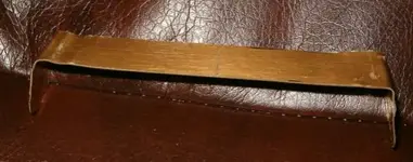

I created a baffle infront of the water inlet, a multi-perforated tube, feeding my Megan's Moth DIY table. I used Rainbird fittings and a heat gun to relax the tiny tubing so the barbed fittings would slide into the clear tubing. The downsized and finished build is posted below. The baffle is pop riveted in, and swivels up and down to regulate laminar flow.
PS. I just asked CP's widow, Denise about you a few days ago. Wanted to know if you were still kickin'. I'm delighted to see your post here this morning. You are a rare treasure to the prospecting world.
Baffle before attaching:
Baffle after pop riveting into position:
