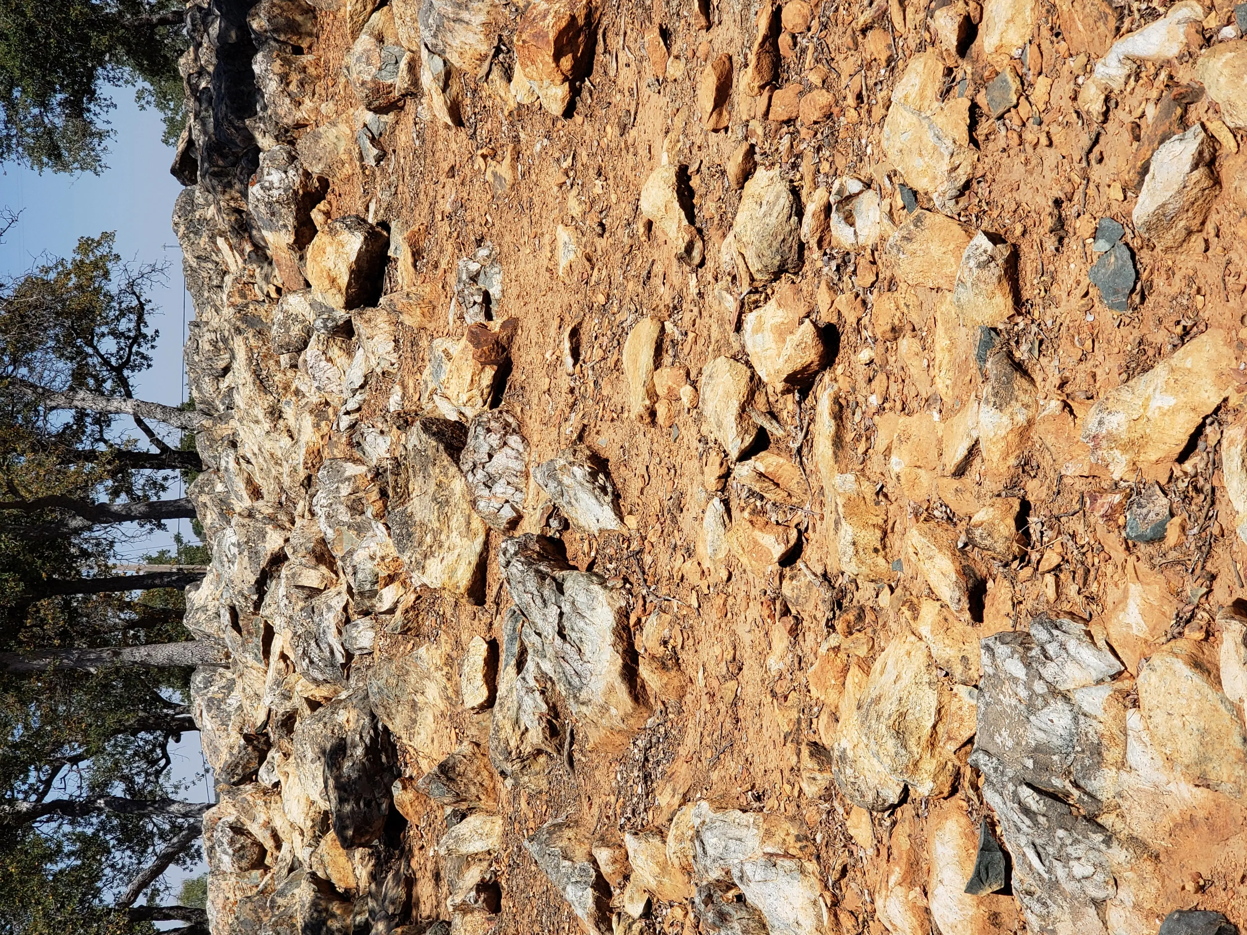

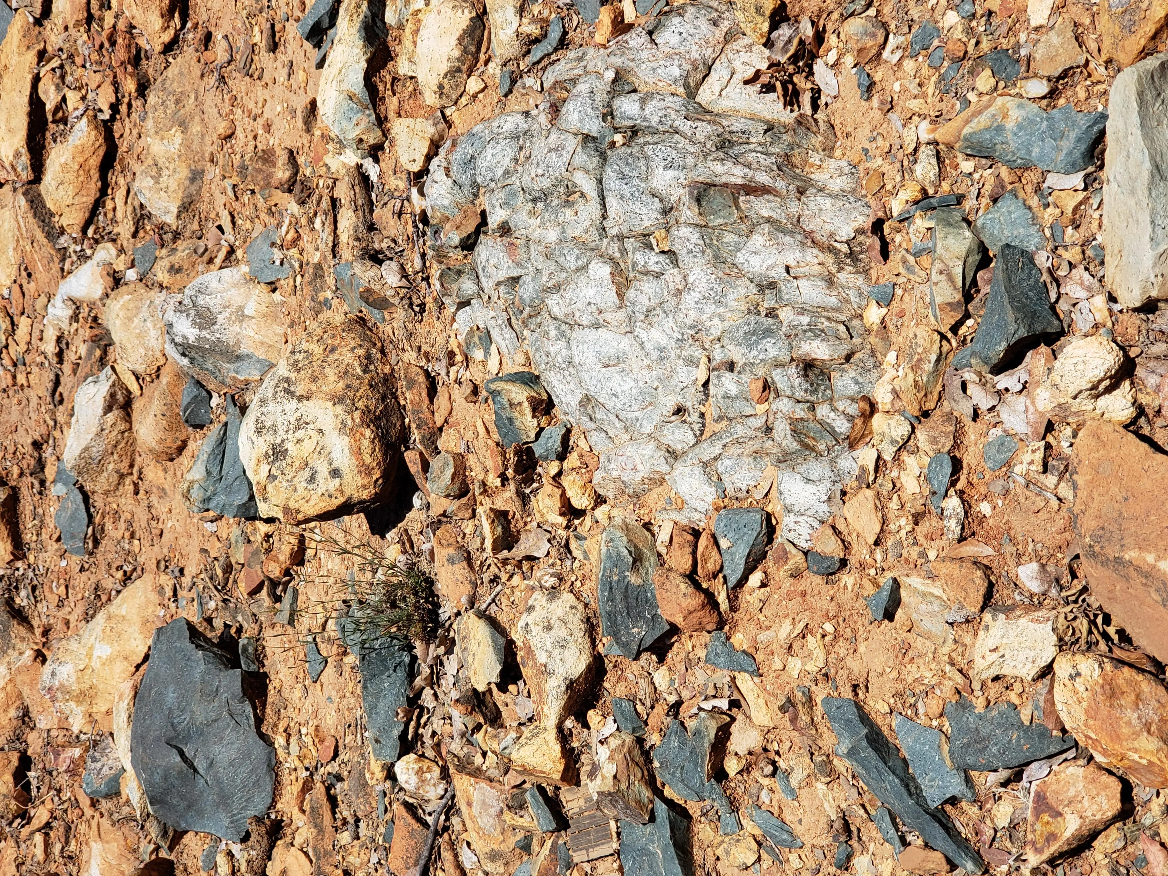

To start, I'm new to this. I've some experience with metal detectors from work but I realize this is a different ball-game, searching for gold. I'm looking to purchase one of the more affordable VLF's. I've been eyeing the Minelab Gold Monster 1000 and also the Fisher Gold Bug Pro. Where I'm looking to detect is near Barrett Cove (I realize this may be a little west of the "Gold Belt") on some family owned property. I've found a couple grained sized small "pickers" by pan after crack and crevassing. I'd really like to run the place over with a detector. Thing is, their soil is fairly red and seems to be very oxidized. Would I be wasting my time with either of these units in that general area? I've read about the PI machines and they sound fantastic. Unfortunately, I can't invest thousands at this point in time. I'd hate to buy a VLF and find out it's worthless, just screaming because of the ground the whole time. If it helps, I'm including a few photos of the general rocks/terrain on the property. I plan to also search farther south closer to home (Fresno) which I don't think soil will be a problem. Of course, not near as much gold farther south either, hah!

View attachment 1859330View attachment 1859331
Contact your state's Department of natural Resource's for the County your interested in about it's mineralization . You've already paid for this in your tax's and there's a host of other info ava. Ask for the free catalogue of Publications for your state ! These are ava. for all state's !
looks like serpentine maybe that and the color make it look like pretty hot ground.
If it is Serpentine, would the Gold Monster 1000 handle the mineralization for him? (If so, perhaps he could borrow one. If not, perhaps someone might help him out with a PI?)
That's what I'm kind of afraid of! Still researching it some more. Thanks guys.
That is serpentine country for sure, and that stuff totally "pisses off" any vlf. However, the SDC2300 will handle it well and purr like a kitten finding the small bits. Probably not what you wanted to here as that detector is pricey.
