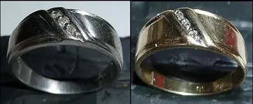

Okay donkey...I have put this stuff down before all over the net but it bears repeating so for both you guys...
Also I have posted this pic below before of most of my gold finds over the years.
The areas are marked or the numbers are from my Fishers.
There are 5 newer ones missing that range from foil up to tabs so I need to update this family pic.
Look at the areas and how many came in where.
Also there is a pic down there too of two different but similar channel wedding rings I have dug, both 10k men's with diamonds.
The yellow gold ring came in as a 35 on my Fisher, the very top of my nickel range and one more number I would be into tabs.
The white gold ring which is a few grams heavier and at least 2-3 sizes larger came in at that way low 24, just about the same area as a condiment package or just a hair above.
I will explain why below.
If one person finds gold because of changing their thinking a little due to this info I will be a happy man.
Many have told me this actually happened for them so I am happy to post this info again.
