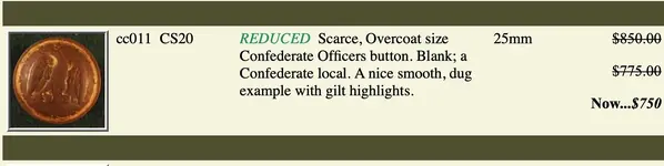

Maybe??? I just found this while researching something else:

That is a nice button. Obviously pretty rare one would think. I think Creskol may have stumbled onto something. This button looks very similar to the one you found.

It certainly could be a variant of this button. I just haven’t found an exact match.
Ripcon, the button referenced (and pictured) by Creskol is Albert-book button CS-20, and it shiows the eagle sourrounded by stars. Your button has no stars, which is why in my previous post I said it appears to be a variant of CS-24, "Upright spread-winged eagle, whose wingtips point downward, no shield, and no stars."
