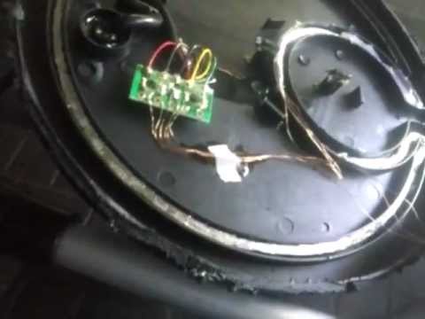

Keep in mind that the Xterra coils were the first SmartCoil technology coils, and that having a chip in the coil presents a bit of a twist previously not encountered. Simple wire windings in an epoxy filled plastic case is easy, but add a chip and the game changes. The stock concentric coil was easiest to make waterproof, but Minelab only makes one waterproof Xterra DD coil.
As for the balance....a lot of folks turn them around to improve that aspect.
I thought there were chips in all the Sov and Explorer coils? I know I saw a pic one time of someone showing a chip or small board that is in those coils.
It's just a distribution board for the windings. No chip.
