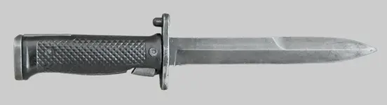

Unless you are referring to the M5 bayonet, see picture. This is later M1 Garand bayonet designed around 1953 and it used the M8A1 style bayonet scabbard like the M16 bayonet does. This was just a later style bayonet that was used by all personnel.
