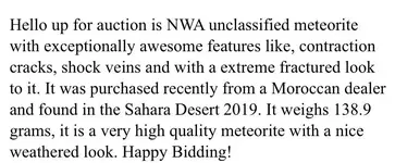

I recently had an interest on researching and looking at meteorites, ive tried metal detecting for them but just found slag and whatnot. I bought this meteorite off ebay and would like to know if it seems legit and if so what type. It seems real to me but ill let the experts talk. It weighs 138.9 grams.

Hi
It's not possible to say "most likely a meteorite" from two pictures that only show the exterior and with no indication of physical properties.
What can be said from your specimen is this:
- the patina and colouration is typical of Saharan or other desert meteorite finds in the stony 'Ordinary Chondrite' class
- the cracks are a good sign and have the typical appearance expected from a shocked stony meteorite (not an iron meteorite)
- the general shape is not inconsistent with an oriented individual stony meteorite
- there are numerous small spherical protrusions which might well be chondrules
If your eBay vendor said this was a NWA chondrite of Saharan origin, there is nothing about your purchase which is inconsistent with that... but that's not the same as saying "it's most likely a meteorite". The most common/abundant Saharan find is NWA869, together with several other meteorites that are 'paired' with this fall and numerous others that are also probably from the same fall but usually sold as "unclassified NWA chondrites". NW869 and its pairings are usually low metal chondrites in the L3-L6 groups but nevertheless have enough metallic iron to be significantly magnetic. Here's a few NWA869 specimens from my collection for comparison at a superficial level:

Thankyou for your reply and you are correct it is from the Sahara desert as he points out in the description
As I said, a meteorite cannot be positively identified from two pictures, but I see nothing suspicious that is inconsistent with his description. He's not making any claims beyond it being an unclassified NWA (NorthWest Africa). He's also not making claims for a specific location beyond coming from a Moroccan dealer. That's normal for unclassified NWAs because that's where Saharan meteorites usually end up... in the hands of a Moroccan dealer who is acting as an agent for the Bedouin people who find them in the desert and derive a useful income from them. The larger strewnfields are mostly just across the border in Algeria, but specimens found there are still generally brought to Morocco for sale.
