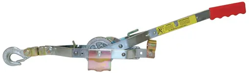

Thanks Mikep691, This just shows how quick and effective a simple digging bar can be to do exactly what I am talking about. It can be used without any anchors cables or ropes. So, the weight of a bar vs the weight of a puller and the use of both. Which would you choose if you could only take one for the sole purpose of moving quickly to roll a rock. Would it be better to bring both? I'm thinking the bar is the way to go. And, the pullers are for the return trip bu then, big pullers are the way to go. Let's say I need to move along a river and sample quickly and get outa there. Wouldn't a bar be better weight to carry than a puller? Then, once I have an idea of the boulders I need to move, choose the puller? I am checking out wrecking bars and pry bars. Also, I like the Maasdam continuous rope puller for the 1/2" rope combined with nylon webbing with eyes for a slip knot for the actual boulder. That puller is 7lbs. and I can choose the length of rope. Maybe taking both, the bar, the puller the rope and a couple of pans, a small shovel and a few hand tools. And a metal detector. I think this is a formidable set of tools and would provide a way to move quick. Here's the set up. Rope puller, 24" or 36" bar, Rope, 8' sling. This may be the minimum for a strong effective set. Heck maybe just the bar without the rope puller would do the trick. If I can move faster and have a light pack that would be the best. I need to prospect not mine at this time. I am leaning toward minimal. Bar, shovel, hand tools, a couple pans....

and, this little guy from Home Depot for $16

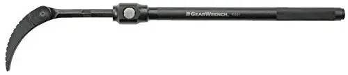

Check out this adjustable pry bar!
Apex Tool Group 82220 GearWrench 18-Inch to 29-Inch Extendable Indexable Pry Bar
About this item
Features
Head locks in 14 positions
Grooved head profile provides additional traction
Head Indexible through 180° for greater leverage
Features six new styles in sizes ranging from 8inch to 33inch in length
Unmatched access by the head of the pry bar adjusted to 14 locking positions
Backed by a lifetime warranty
Exceeds ANSI requirements for proven strength
Extendable for added reach into tight spaces
Part Number82220
Apex Tool 82220 GearWrench 18Inch to 29Inch Extendable Indexable Pry Bar.webp

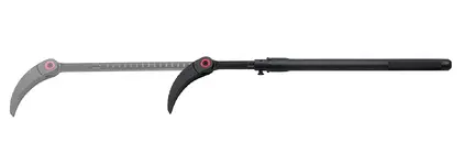

HAD TO HAVE IT! Amazon had the best price on the internet. Then this morning they had a 29-48" one for $62 used/acceptable with free shipping. I just couldn't resist!! It's 5.28lbs and pack-able at 29". I was already prepared to buy a pry bar at about 24". A big digging bar was out of the question. At 4' long plus the movable piece on the end which greatly improves leverage and usefulness. I just think this thing is a great addition to my tool set!! A lot of places sell this for over $100 plus shipping. This was an excellent deal. I really don't care if there's cosmetic damage. I feel kinda like a banged up pry bar is no big deal. I needed a tool to move big rocks and be pack-able. This is an excellent tool! :headbang:

Right Vance! For me, this is a fun hobby. I have no delusions that I'm going to strike it rich and quit my day job! But, that bar is just way too cool. I couldn't pass up the sale on it. I'm sure I could have spent $15 on a bar. But, look at this thing! Its got some skills!! I'm having a great time with this hobby. This will only make it funner!
I understand you're packing in and need lightweight, etc. No offense intended at all but I'll almost bet you'll find that 5lb bars' limits REAL fast.....?????? Either way....please let us know how the bar works out even tho I have my doubts.......
Hey oneguy, will do. Gear wrench has an excellent reputation. The website says the line of indexable prybars are stronger than regular prybars of simular size. The reviews I'm reading are saying the same. I am hoping to report this as well! I'll have it in a week or so.

Point is, a $15 bar works just as well as a $50 bar with "moving parts". Maybe better when those parts that weren't designed to handle a 400 pound rock no longer work. Just food for thought.
Mikep691, agreed, however, I dont want to lug all the weight. I'm paying for light gear. Weather or not it works and is durable is yet to be seen. Chances are good it will be. Soon to know!

The shorter the lever the more you will need to use your muscles/body. Be careful with your short bar as one can easily tear muscles such as the ones around the shoulder joint when moving 'heavy' things. Damage to the self can also be accomplished with longer bars especially when one tries to move increasingly larger boulders. At some point something has to give, be careful to not damage your shoulders, back, knees & etc.

I'm not slamming your decision for this bar, just saying it may not fare well when used for other prying that it wasn't intended and designed for. I too look forward to your review. I hope I'm wrong in my judgement, but any tool designed for a specific purpose, usually doesn't fare well when used otherwise. When I have to hike, I don't take my big Bertha bar, I use a 3' pry bar with one point and a pinch point other end. It's not too heavy and can fit in the pack. Not the best as it is limited to what it can do, but if you're just sampling, there's really no need to move boulders. Like Victor said, Let the gold dictate the tools, and how much it's worth.

OK, so packing light.... $50 for a sliding, ratcheting 5 pound manhole cover remover that weighs maybe 100 pounds versus a 400 pound rock.... I got $20 says the rock wins.
