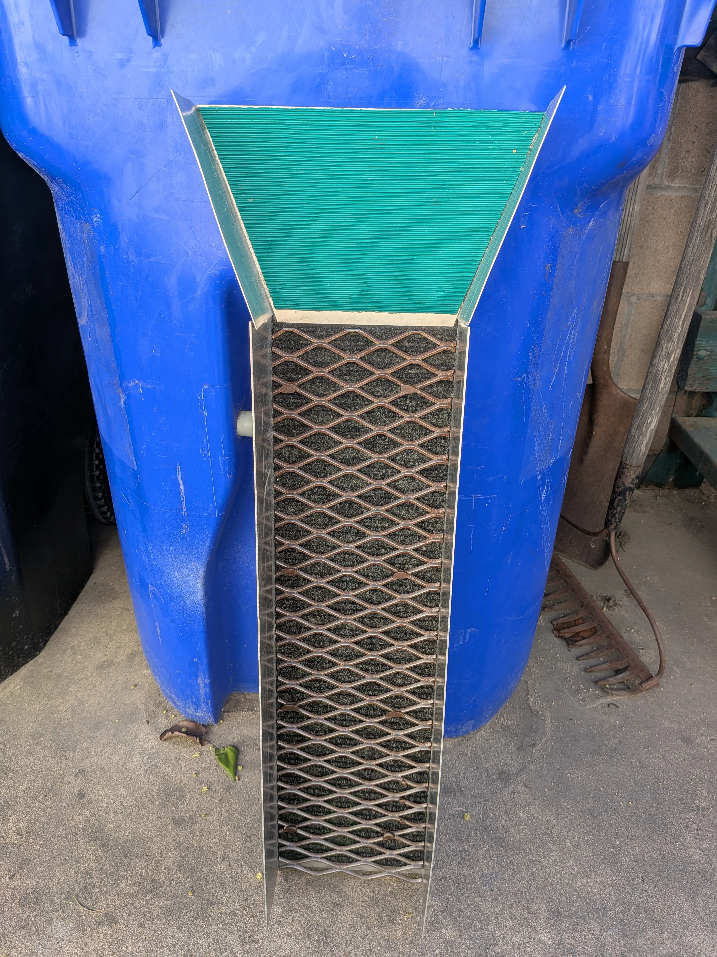

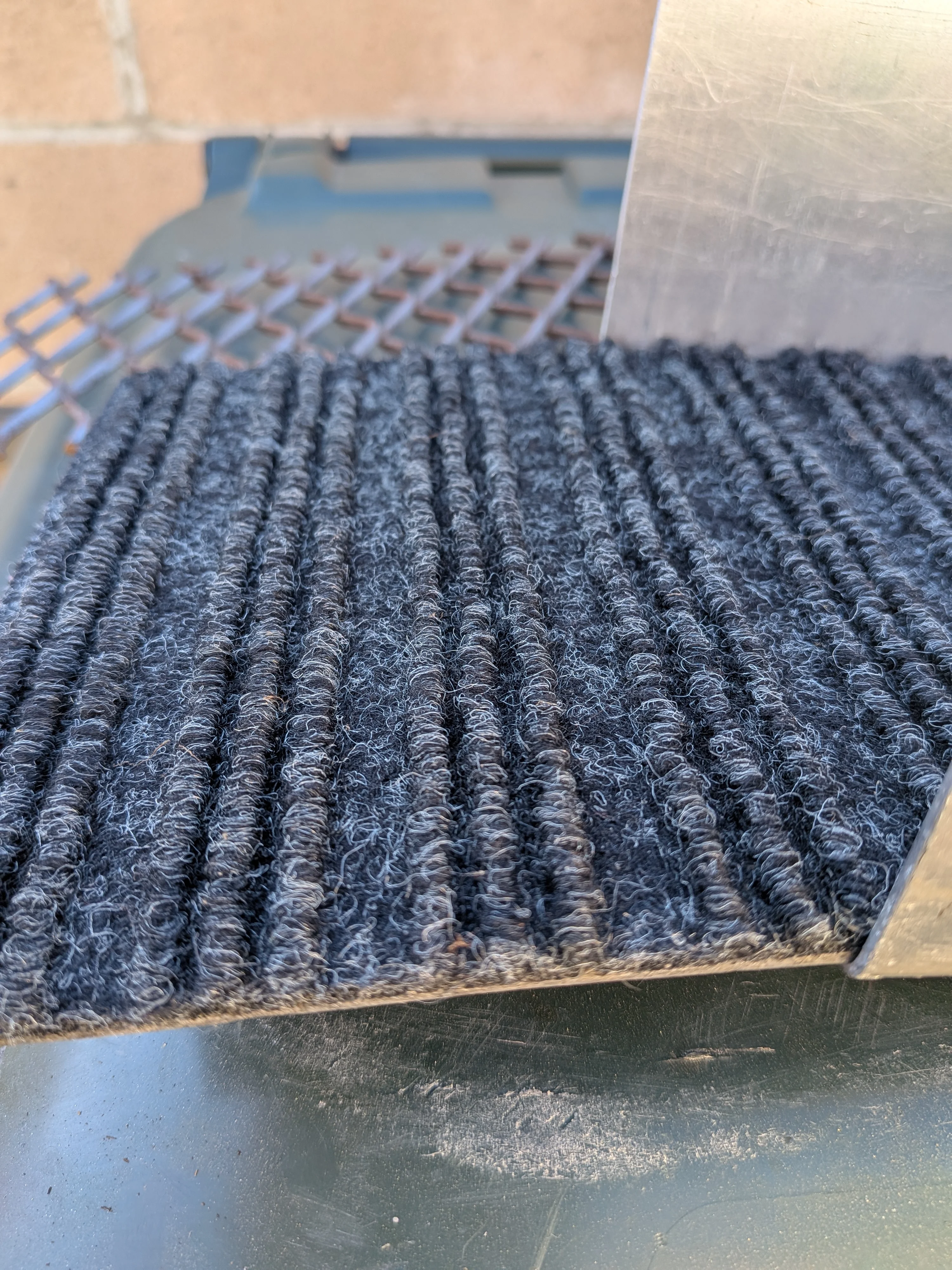

I know its a old post lol just wanted to say sometimes less is more meaning this little Sluice 22" long X 6" wide has caught more fine gold then I can count. Basic setup is High Low Riffled Carpet with 1/8th thick 1" Expanded Metal.
It appears that the carpet just tucks under the aluminum sheet metal, right?
What holds the expanded metal in place?
Thanks.

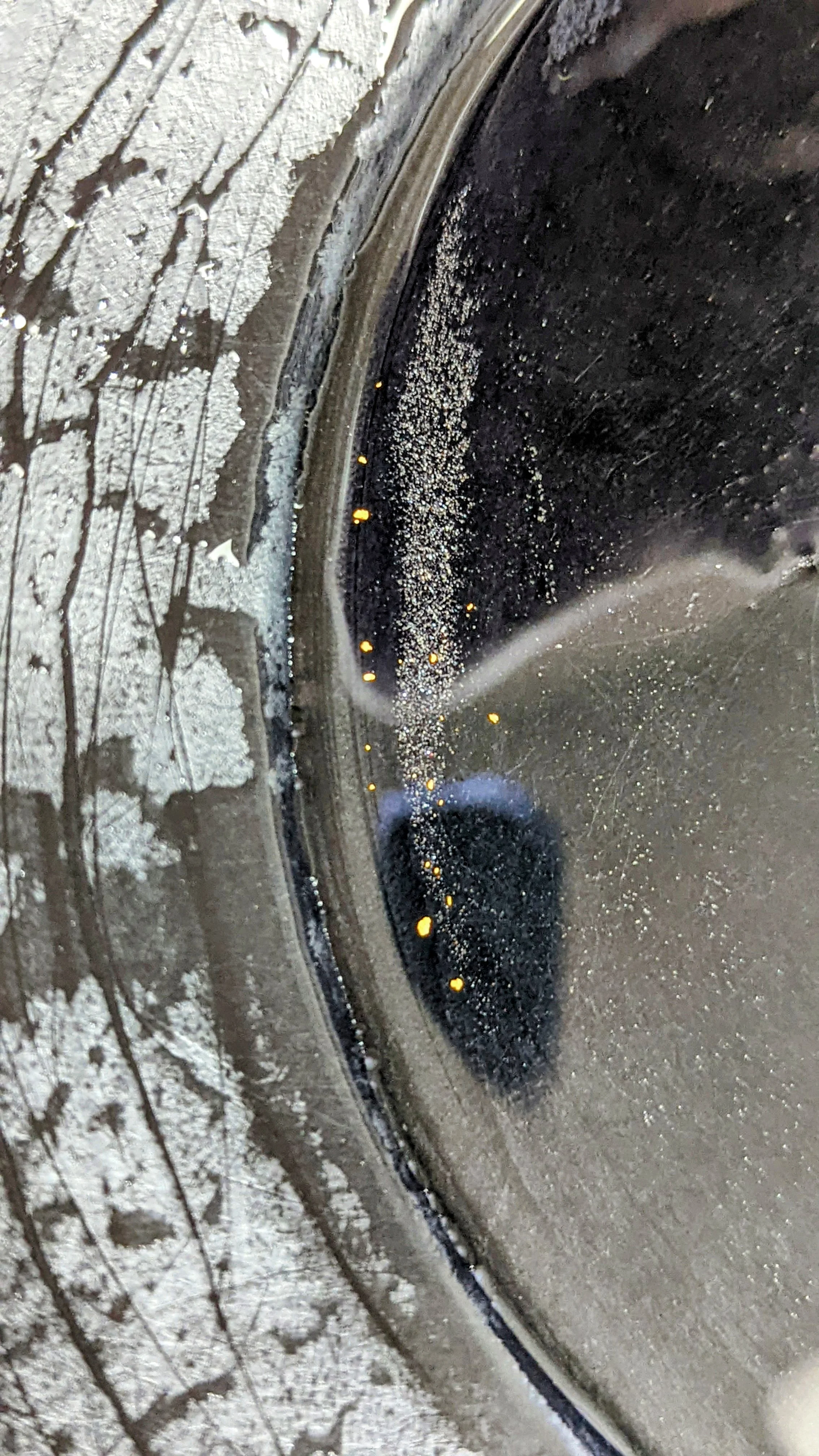

Good morning Assembler. This is a Sluice I made the carpet is held down by a piece of .020 1/2 hard stainless steel. The expanded metal is a snug fit and just pushed down and is locked into place. The carpet/door mat is from home depot I just cut to size lol. I measured some of the fine Gold with my digital calipers at .002 and I think that's like 200 mesh but it does trap a lot of fine Gold lol.
That is what I was thinking for the carpet hold down. Thanks.
