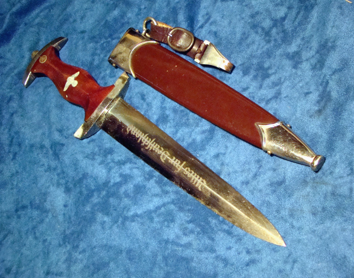

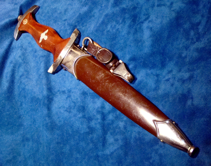

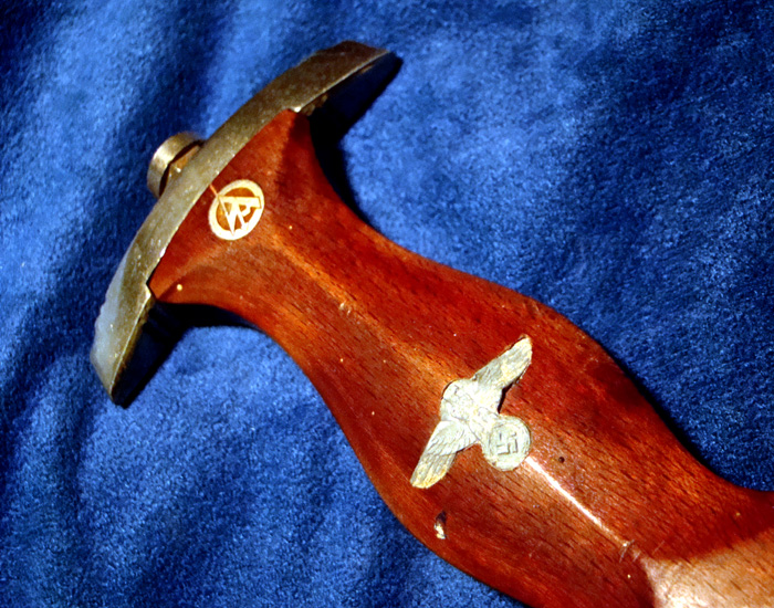

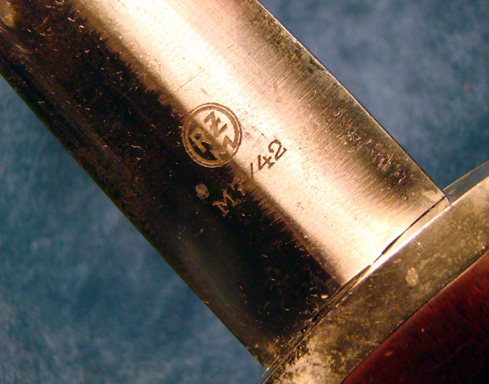

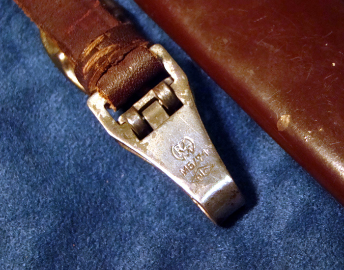

Was out picking the estate sales this morning as usual and got into some neat stuff. The sales company stopped tagging and missed some of the best stuff in the sale. This was among those things I placed in my pile. They just looked at the pile of items and charged $65, hoping this is the real deal but I won't cry if it's not. The markings look pretty good but I'm no pro at these.

Worst case scenerio you can have a fake,second worst is a thrown together post war dagger that were sold to the occupying forces as souvenirs.Third you have the real McCoy.Its just to tough to tell from pictures.
Any two letter markings on the crossguard denote the "Gau" (state) the SA member was issued the blade. Late war daggers were NOT issued with these marks. As per my post in the Garage Sale sub-forum I cannot stress enough that this dagger is 100% good in my opinion and realistically valued in the $500 - $600 range.
Thanks GregK! I tend to be a pessimist and since selling stuff is my game, I would hate to have a buyer go nuts on me.
Only problem being is that all nazi daggers were usually marked Solingen and had the makers stamp on the blade.The distribution marking is also missing (it may be there but I cant see it) from the hand guard.The RZM marking is only a control stamp.
Solingen markings are not required. Most early and pre-war daggers (regardless of branch) were sent out with full company trademarks and logos which often included the town name of Solingen in them. As the RZM came into effect any political material was required to have the RZM marking. There was a transitional period where most of the blades would have had both. The later the dagger the less likely it was marked with anything but the RZM marking. As posted in a previous post the "Gau" marking disappeared on the late war pieces.

What you appear to have is a late SA Dagger, RZM M7/42 which was manufactured by WKC.

Your assertions are incorrect, RJ. First, "All" is inconsistent with "usually". Something can be one or the other but not both.
Not all daggers were marked "Solingen". Not all makers were even from Solingen; Aesculap AG was in Tuttlingen, Fritz Barthelmess was from Muggendorf in Bavaria, August Bicke was from Steinbech-Hallenberg, Julius Bodenstein was from Steinbech, Adolf Braun was from Berlin, and many more were not. But this one was made by W.K.C. (Weyersberg, Kirschbaum & Co.) from Solingen, who had the M7/42 RZM number. But the word "Solingen" wasn't on all their blades.
The "distribution marking" or more properly, the SA Gruppe marking, normally (on non parts daggers) only appear on pre-RZM daggers, about 1935. The lack of a makers mark suggests a manufacture date of 1938 or later, as does the black painted scabbard, the only difference from an SA dagger.

I have a few concerns about your SA "Everything for Germany" dagger , I have a couple of SS Daggers "My Honor is Loyalty" and one Hitler youth "Blood and Honor", all of them have a serial number etched on the cross guard, with the pictures you've provided, I do not see one.
Second, the wear looks ok, but the overall appearance looks too good. I am not saying its not real, by all means it looks real. These concerns are based on my opinions.

Not a big deal. Serial numbers were the exception, not the rule. Take a tour through any reputable reference like Wittmann or Johnson.
