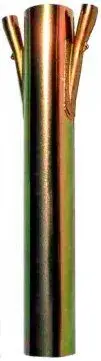

Ok now on to you questions, they do make power jets that run off of 2 pumps for parallel pumping already. These are on larger dredges (over like 5 inch) and utilize 2 2" pressure pumps to operate them. I'll attach a pic below. As far as series or tandem pumping for a dredge operation that would double your pressure but won't increase your actual flow rate. Honestly I think this would do more harm than good as dredge fittings and appliances aren't designed to operate those higher pressures and double the pressure and velocity of rocks and material heading into your sluice box could be quite the mess or blow right out the end.

To dredge at extreme depths,extreme hose length or huge dredges that's exactly what ya do. On a 10" dual vw and 1200gpm precision pumps dual jets is beneficial for depths greater than 35' or hoses bigger than 8". At 50' 3-of the same required on a 10" and blackness surrounds you...John

Looks like dual port heads on the VW's. Now that's a dredge. Must have been hell to get her in the water though...
