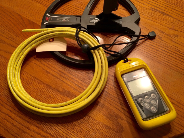

I can take the at gold in the river and not have to worry and in deeper water without buying an antenna for the XP dues. The gold is a great detector and is not mentioned much. It can do alot and deeper than the at pro. As soon as I started hunting with the gold I started finding large and half cents the at pro missed in a field I had pounded. Not saying the pro wouldn't find them but the gold blew my ears off on them. It found alot of old silver also. The deus does everything great just isn't one I'm willing to take river hunting.
I'm going to do it as soon as I get around to making my antenna.
