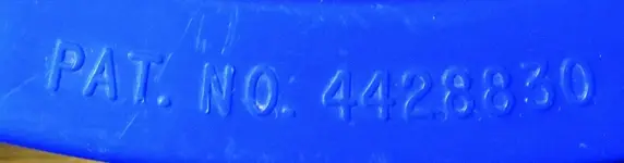

Picked up a used one......
That's cool also...looks like one of the ones before he passed in 92. Does it have D.A.M. Ind stamped on the upper rim? Well in the mold on the rim.
Yes I see it.
After my father passed my (urrrggg) step mother sold the Blue bowl and molds to Frank at Pioneer in Auburn Ca.
