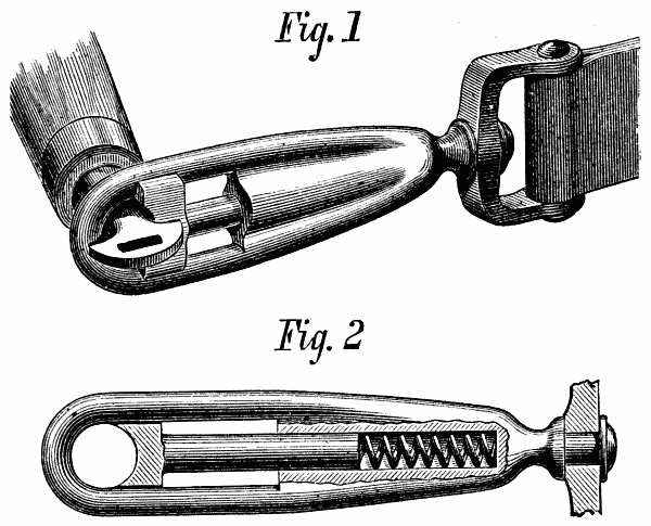

Im moving Dans pic here after resizing. The brass piece may have been pushed up tight against the looped steel (by a spring?)and held in place with a dowel. Something has made those indentations. Maybe what it was attached to indented the brass. And something needs to hold the brass piece from simply sliding off. :icon_scratch: I think this is solvable.
Where the steel is looped around, is there an opening? ..or is it cast iron.
Is the other end a hex head?
I think you're on the right track. Perhaps there was a spring around the shaft which would hold the brass fitting in place against a shaft. Similar to this "Improved Harness Cockeye" patented 1876.
DCMatt
Does anyone else agree that the assembly was probably mounted through wood and as the nut was tightened it pushed the brass against a likely wooden cylinder shaped object inserted through the iron hole? This would account for the wear on the brass.
