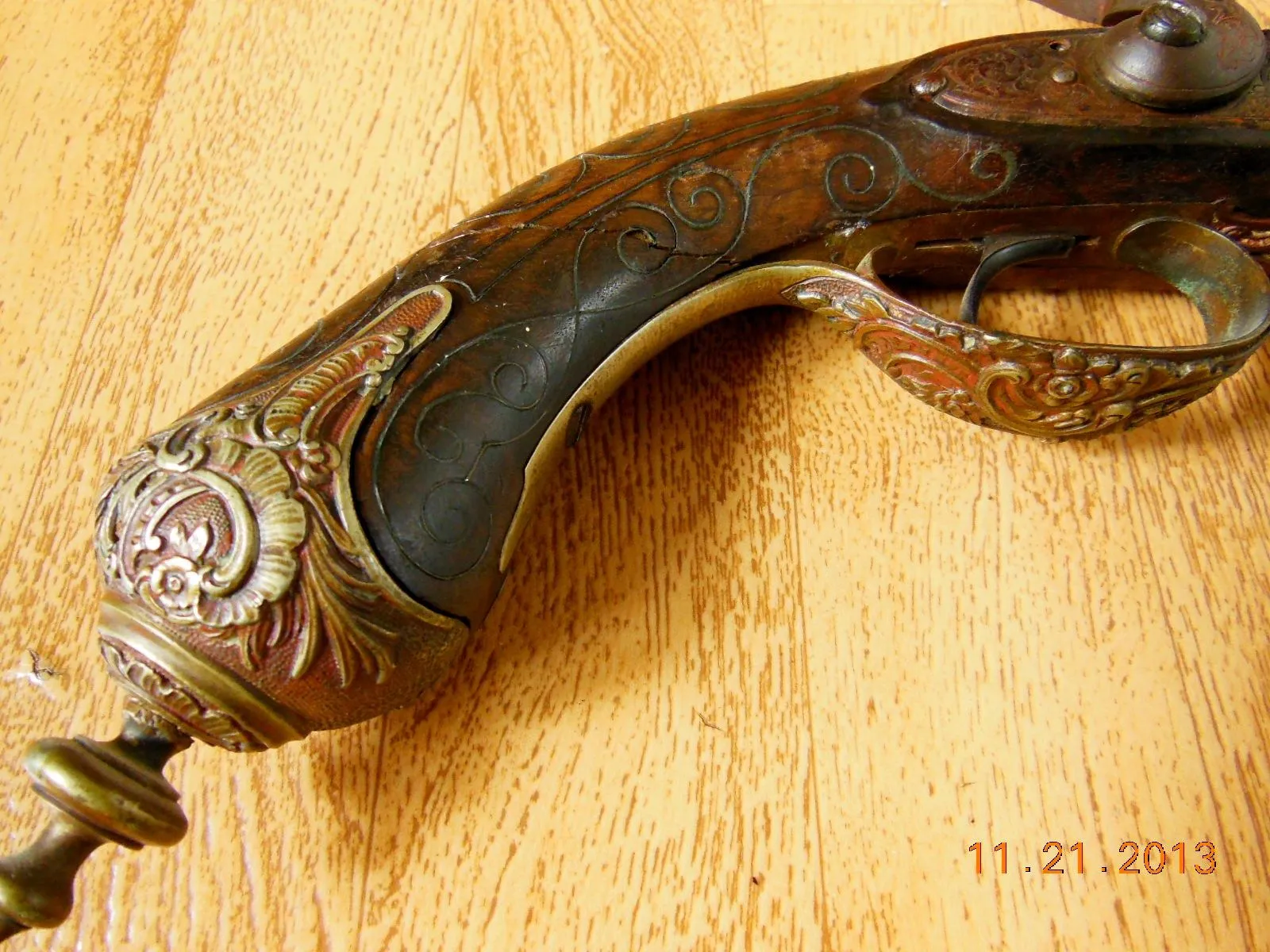

So...here's an old, some kind of gun, anyone know what, when or where about it? Thanks much! FSCN2278.webpFSCN2279.webp

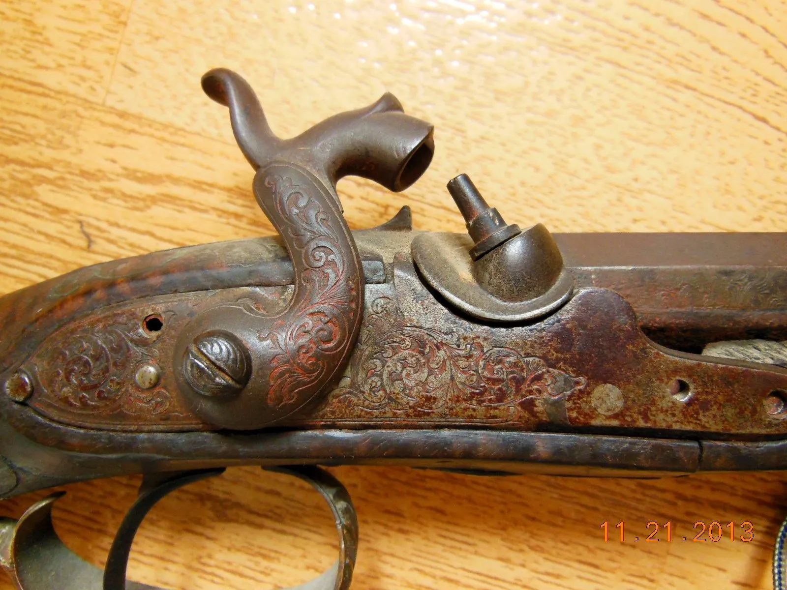

Need markings or close ups if possible.All i can tell you now is its percussion,possibly converted from a flintlock.

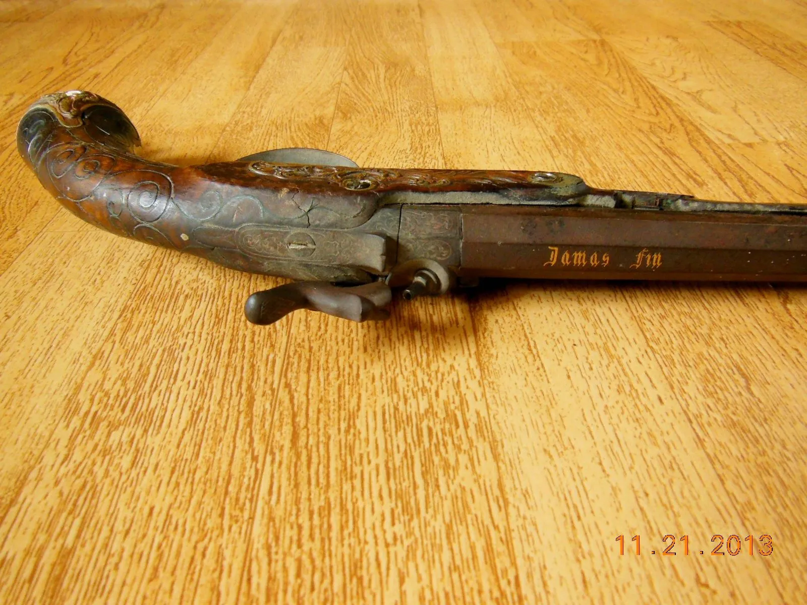

Sorry, forgot to say that it does have " Damas Fin" in gold letters on top of barrel and that's about it.
All i found so far is Damas Fin means "fine damascus".Being damascus,dont fire it,the barrel could blow.There might be a name or marks if you took it apart.Look in the barrel,Is it a smooth bore or does it have rifling.

Definitely has a French look to it, especially with the engraving.
Wondering if this could have been one of a set of dueling pistols?

Hello WolfmoonX.....the only markings are the crisp gold words on top of barrel that say "Damas Fin", if you zoom in you can see a little. I can take a picture of it, should have before right? duh!
I think you have a flint lock pistol that was converted to percussion. The side plate with the hammer/ nipple has extra screw holes which would have been used to mount the flintlock hammer mechanism. The flash pan was replaced with the nipple. It is my understanding that this conversion was quite common as this was more reliable than the flintlock.
I figured I'd pass some info along.
Definitely Belgian. The most widespread manufacturer of "Wall Hangers" and "Mantle Magnets" Haha!
The dead giveaway is the grip being capped and spired as it is. The floral script is an added confirmation. If I had to guess, based only on the pictures at hand...1825-1845.
"Damas Fin" is one of the "rarer" metallurgical proof inscriptions, but even it is still very common on examples.
("Damas Turc" or "Damas Turc Fin" being the most prevalent.)
The "Damas" markings were NOT strictly Belgian, so I will eliminate the other "Damas" proof users below with reasoning.

Just a few more pictures of the gun for you guys.....:)DSCN2421.webpDSCN2414.webpDSCN2419.webp
