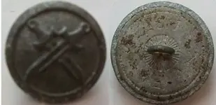

Pic#2- Crossed Swords on the back letter at the top is F on the left side is K on the right side is AS and on the bottom is AS
Buttons1.webp​

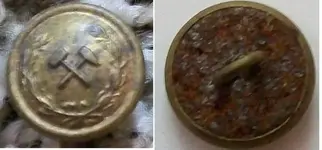

Pic#5- Two crossed "hammers." One has a pointed side other does not. (Can't make out words on back)
Buttons4.webp​

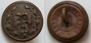

Pic#6- Letter P on front? Words on back say "Superior Quality"
Buttons5.webp​

Pic#8- Top- Fireman? (Can't make out words on back)
Bottom- Two crossed "hammers" similar to button in pic#5 but no surronding "plant" and more details on hammers. On the back is the letters W I E N M and a small plant
Buttons7.webp​

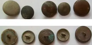

Pic#9- Five plain Buttons. On the backs from left to right,1- EXTRA, 2-nothing,3- a small IA? followed by QUALIT(A?)Y also with a bird, 4-nothing, 5- E X T R A R
Buttons8.webp​
