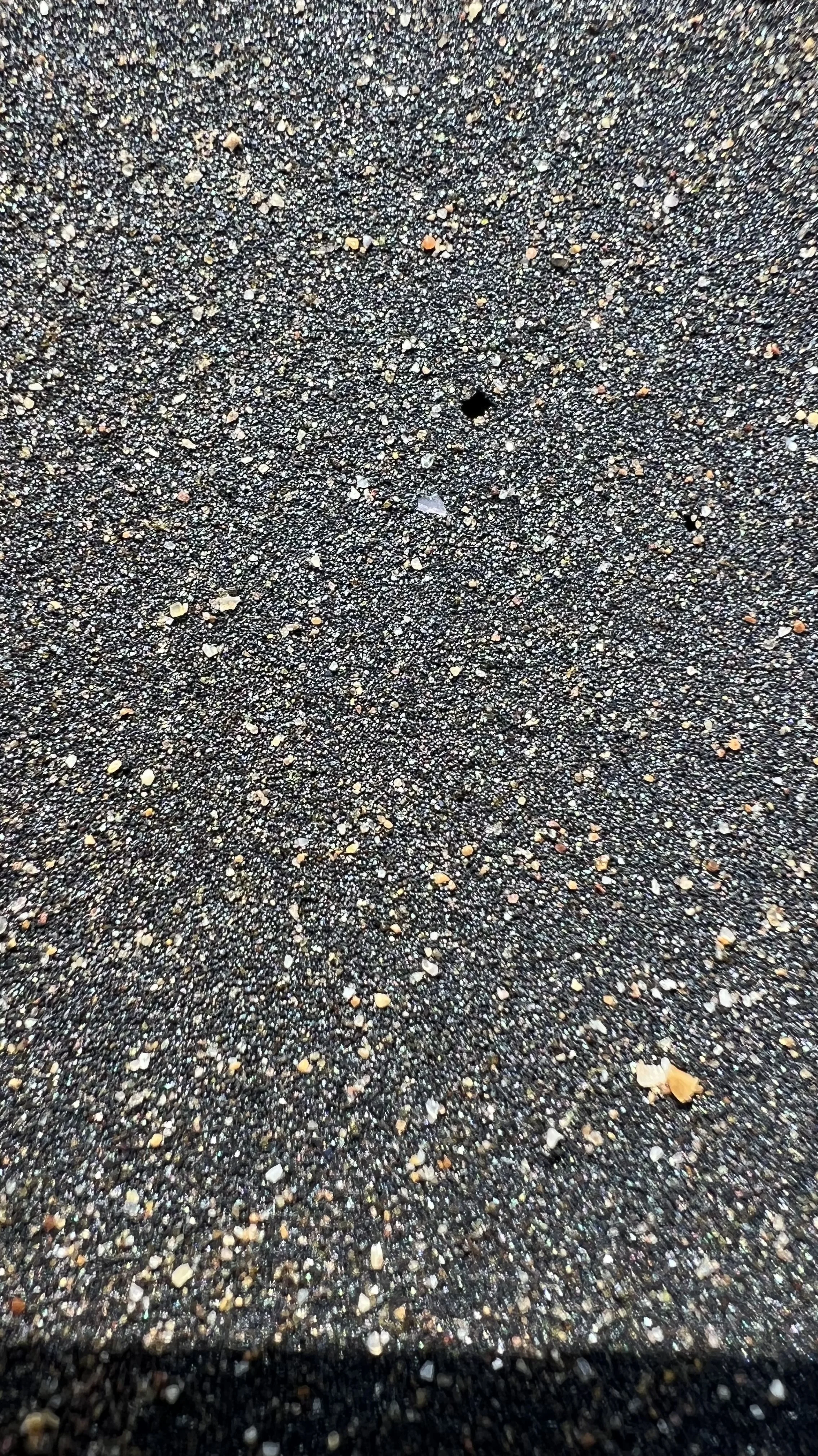

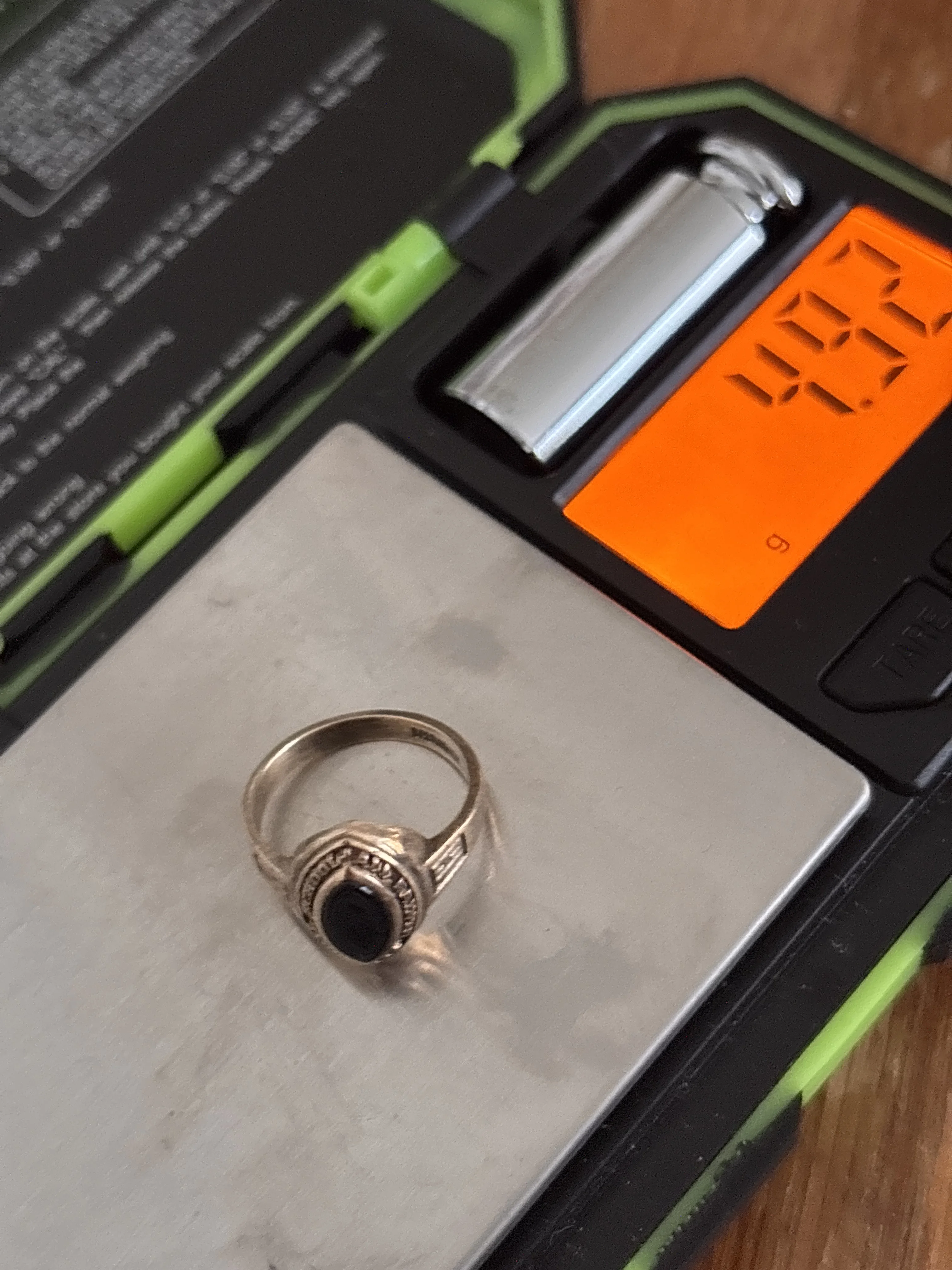

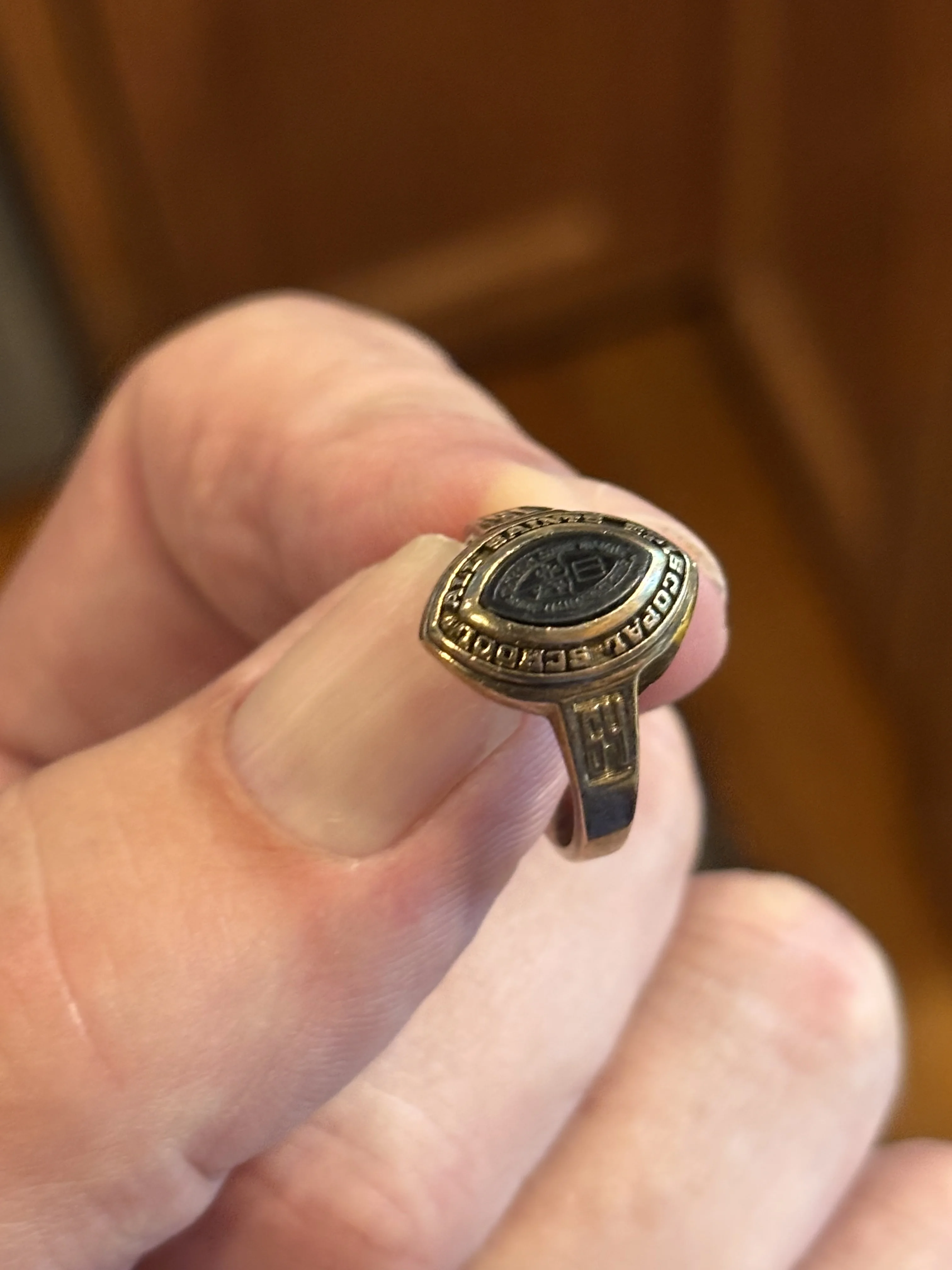

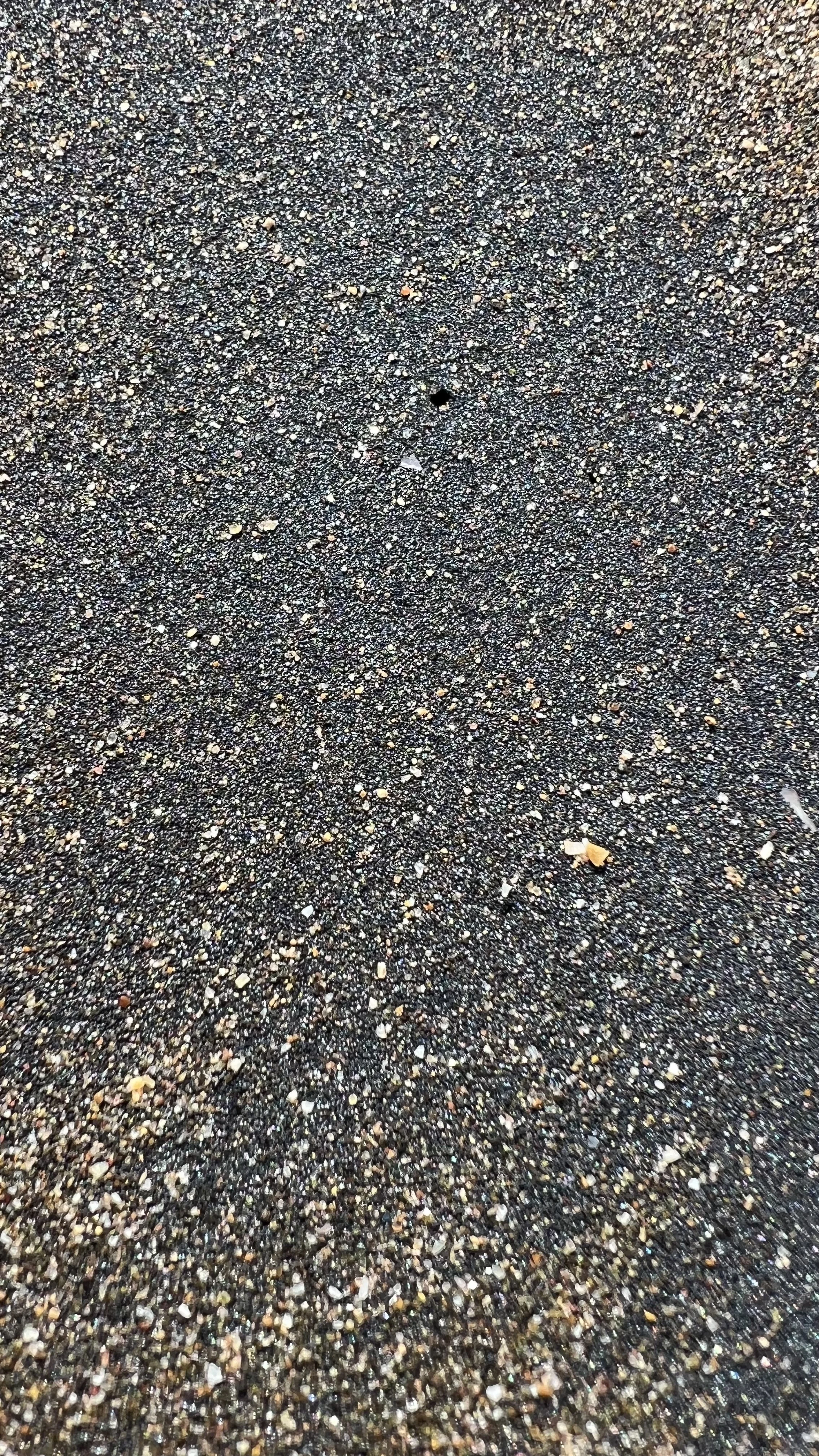

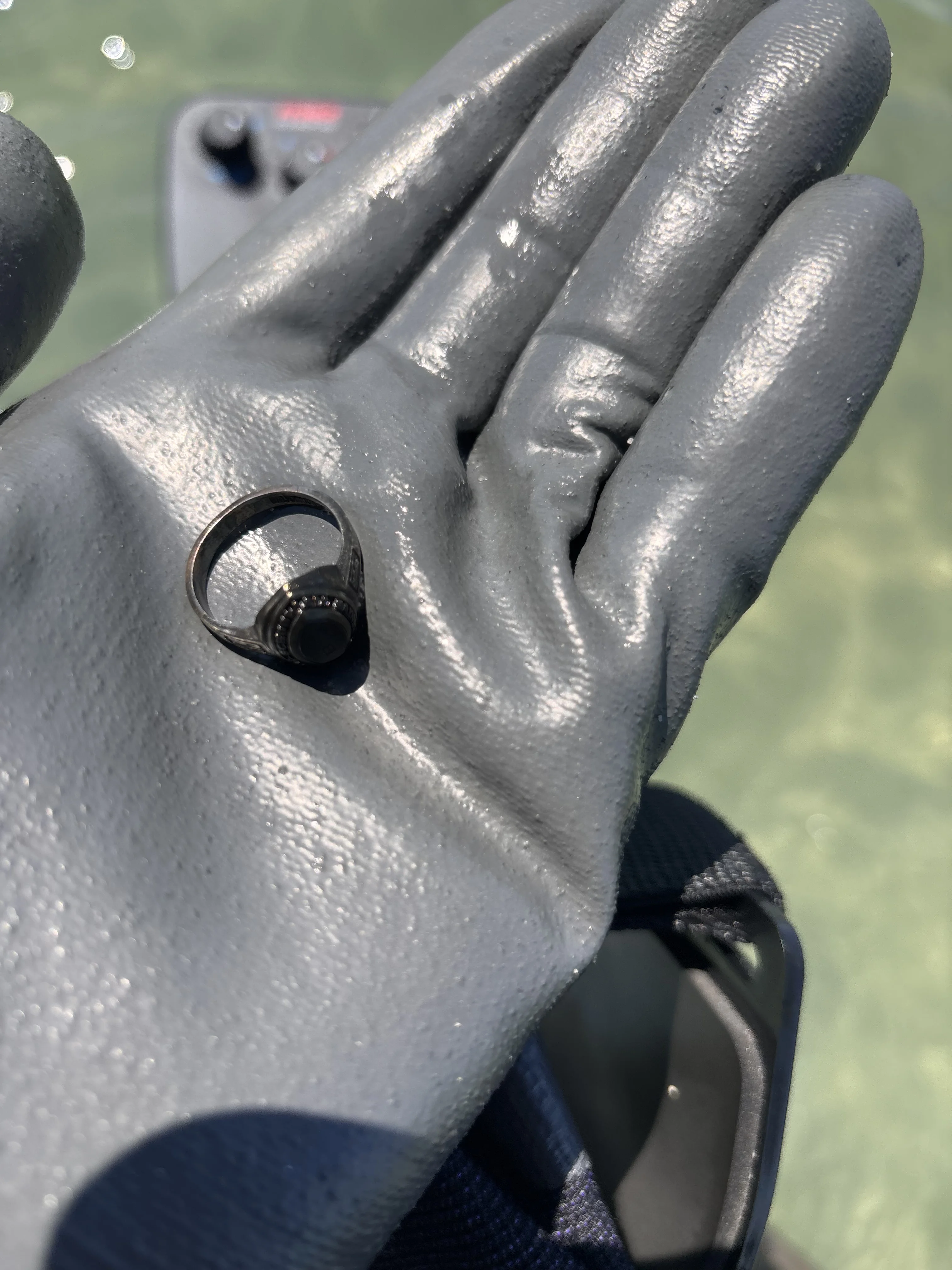

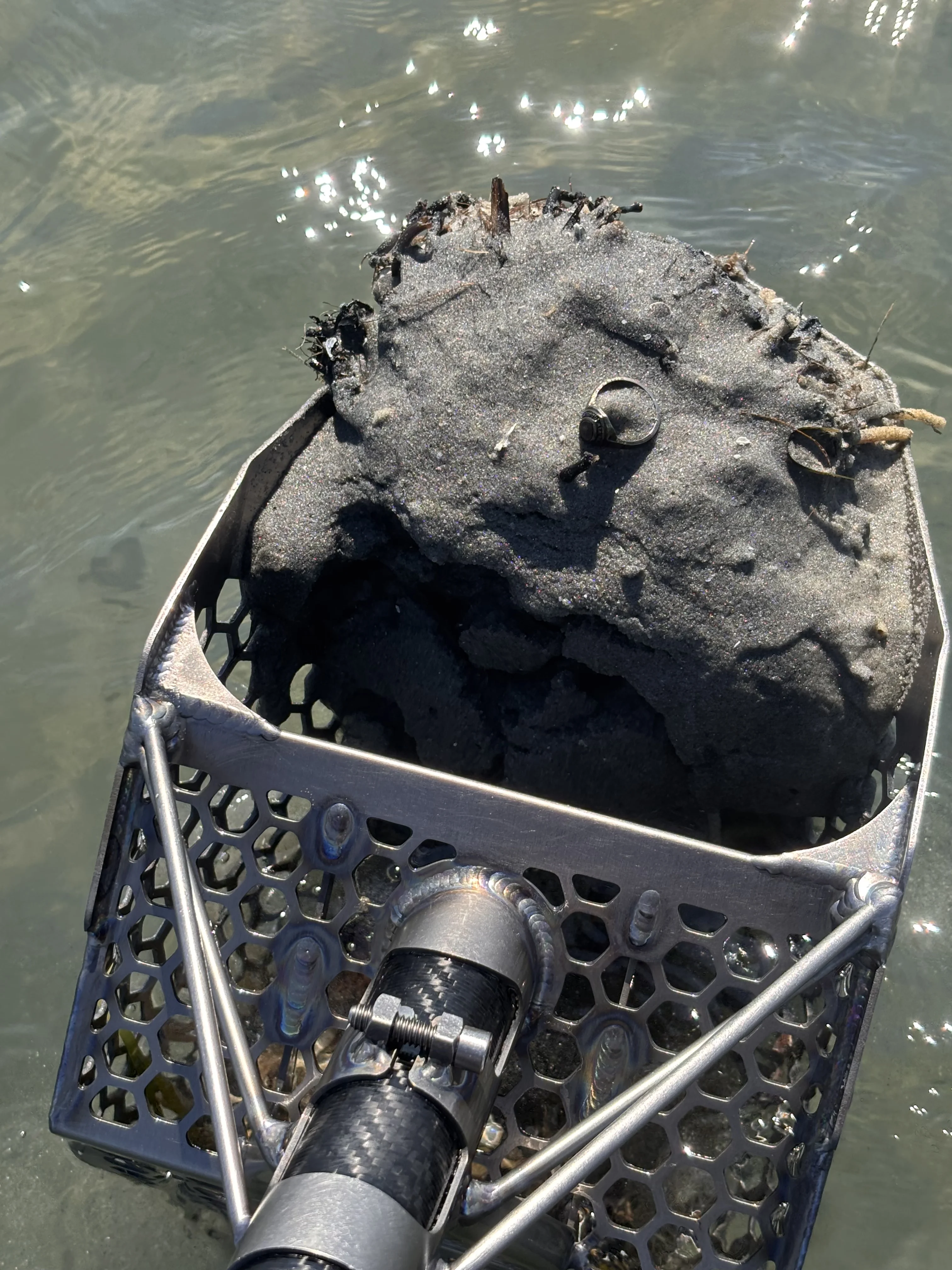

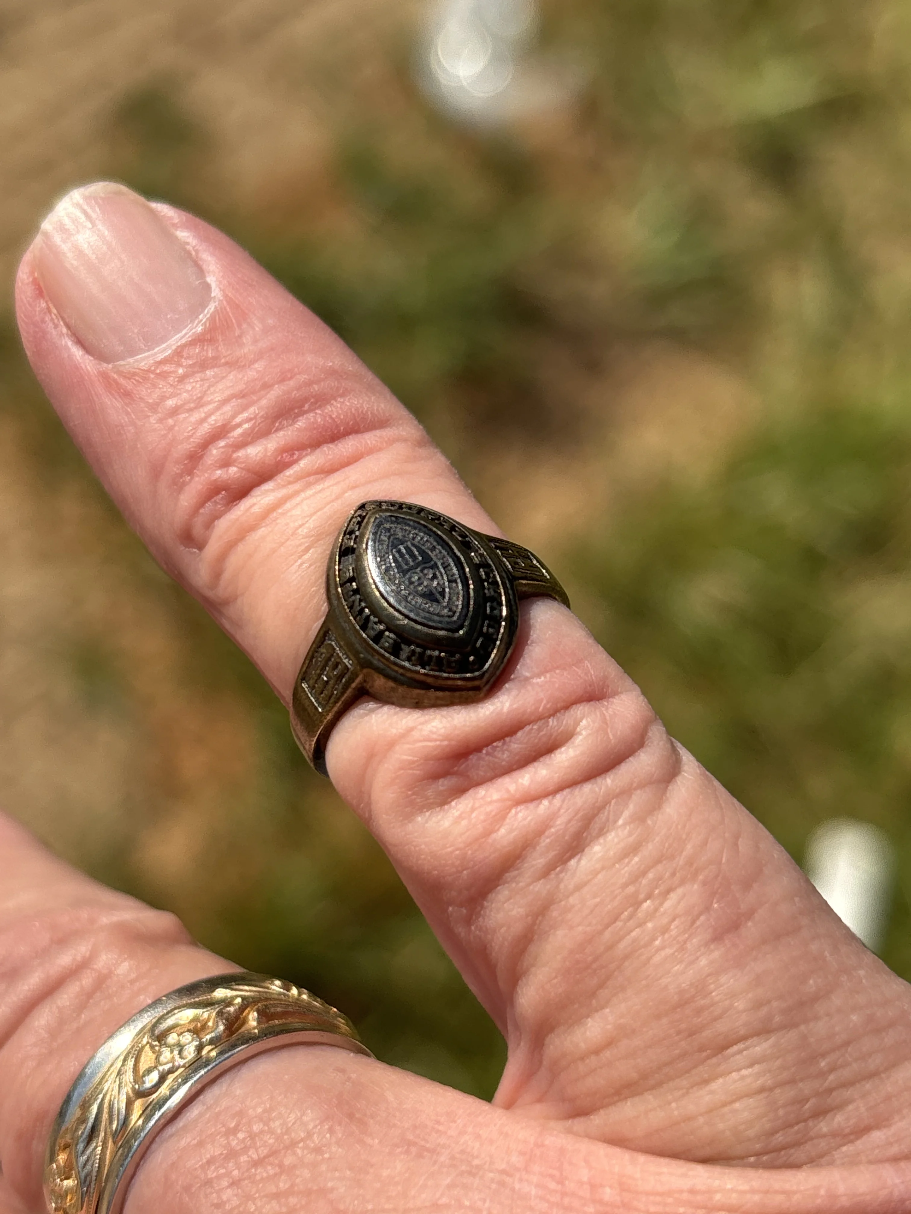

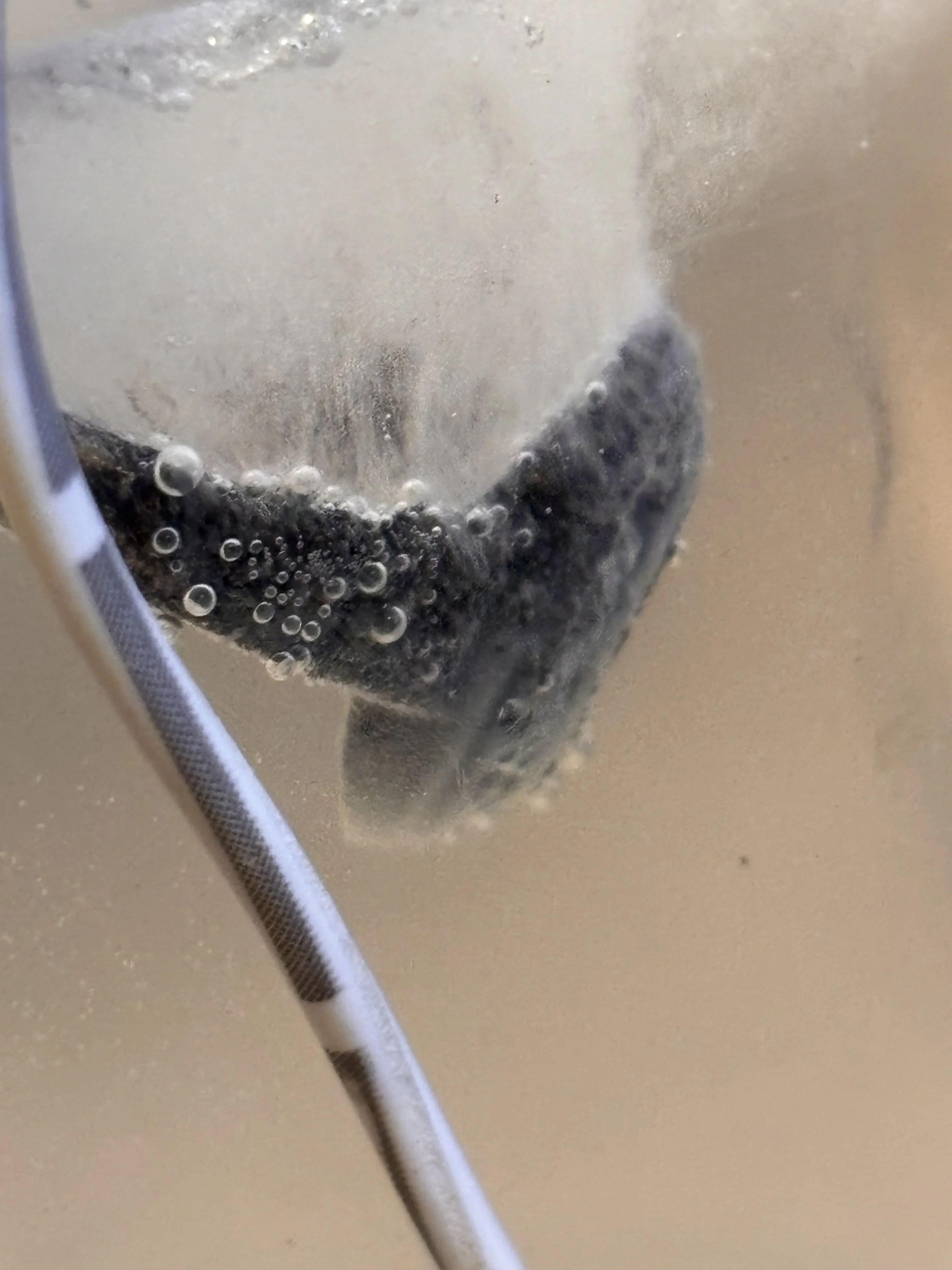

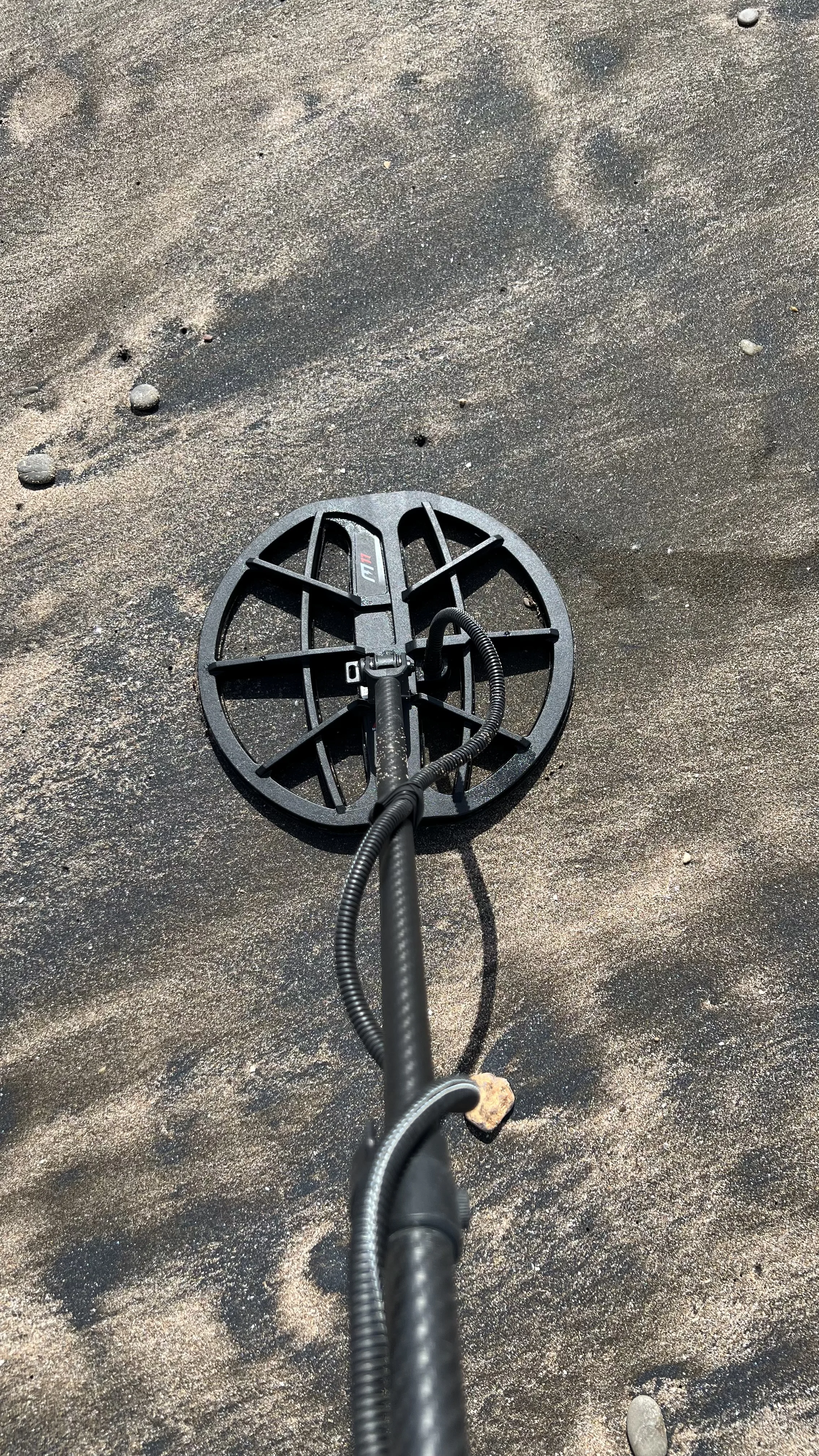

Simply a fantastic day, perfect conditions sunny blue skies 75°with a slight offshore breeze, low tide in the afternoon! Went to a beach that has extreme black sand. I don’t know where it ends because I haven’t dug down deep enough to find out! Not many hunters hunt this area. Well today I did for about2 1/2 hrs🏴‍☠️☠️🏴‍☠️

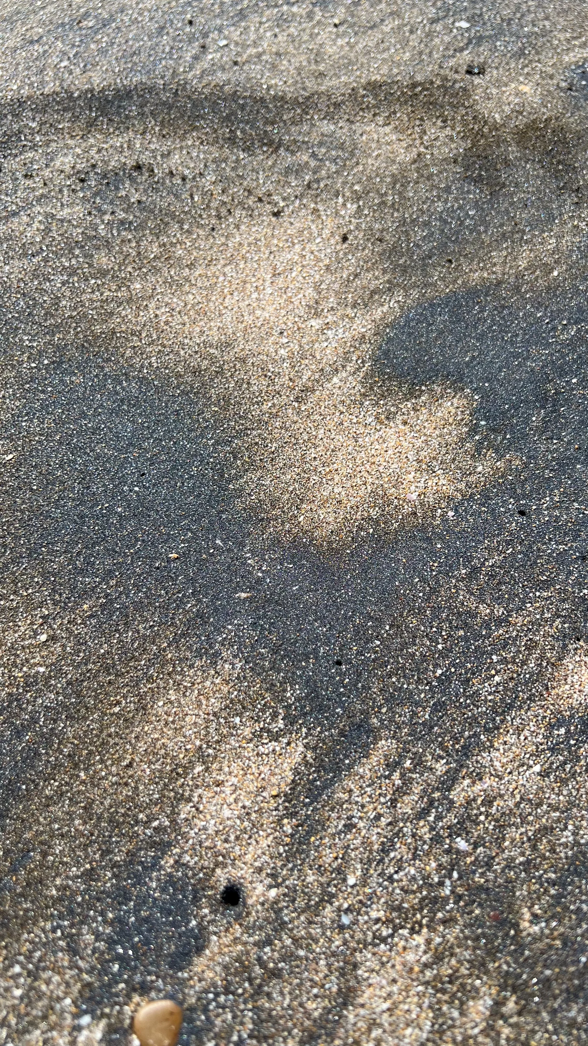

We have all types sands in one beach. From neutral to extremely heavy mineral.

For me and my black sand environment, one of my hunting partners uses the Manticore 👍🏻 with the small coil. She does very well. Also see does not like Digging deep, it’s too much work! Me and my 900 did great too, a good foot to 16inches in black sand mix with blonde sand and getting heathy hits!

In general, all metal detectors don't work well at all in those streaks or swirls of black sand in the beach.
It is magnetic sand, Magnetite is a black iron-bearing mineral that has its own magnetic charge.
If sweeping over a dense patch with a multi-frequency machine, manual ground balance over the dark swirl itself and dropping manual sensitivity by 2–3 notches often calms the coil down enough to pull targets out of the streak.
And comeback to auto GB.
It is so hard to me to give you right setting. Try this may help you.

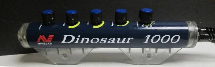

Excalibur here my friend Hamid, for the last 18 years, 14 of those years My Excaliburs/BBS tech has dug more gold each year then any of the new machines (per hunter) in the Chesapeake Bay and Ocean City Maryland. Those new machines would be the D2s, many Manticores, all of the Noxs, etc. They are Great machines but the BBS machines can hang and do as well if setup correct... other then micro pieces of gold, that area BBS is very weak. As far as trashy beaches where there are multiple targets,......... that is rare here on the dry beach and in the water. On land yes, separation speed is needed here on the dirt/land. Also I would agree for those hunting the drysand the new machines are much better as far as weight but in the water where most of the gold is here... the dinosaur rules..
And there are very few of them left, most now swing a modern detector
On many of my post over the past years you will see my recommendations..
Buy those Noxs.. then more recent Buy those Manticores! I say that for one reason, saltwater is the great equalizer..
So buy those New age machines!!
