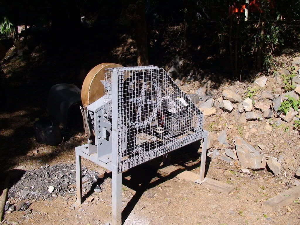

Still in exploration stage now but I am setting up a small jaw crusher and ball mill to do some larger samples.

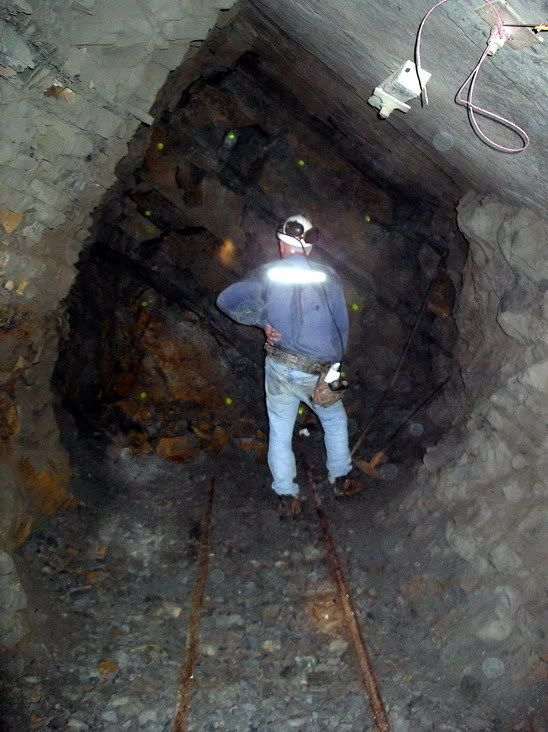

The tunnel we are driving is a extension of a 500 metre long tunnel driven in the 1870's to access a rich ore shoot at a deep level after flooding in the upper levels stopped work. The old timers never hit the rich ore shoot again and went broke. We have done alot of surveying and think we need to tunnel another 20 metres or so along the reef to get into the main ore shoot. We are going up this weekend to fire a shot at the face and we should be 2 metres closer. I'll post some more photos next week.

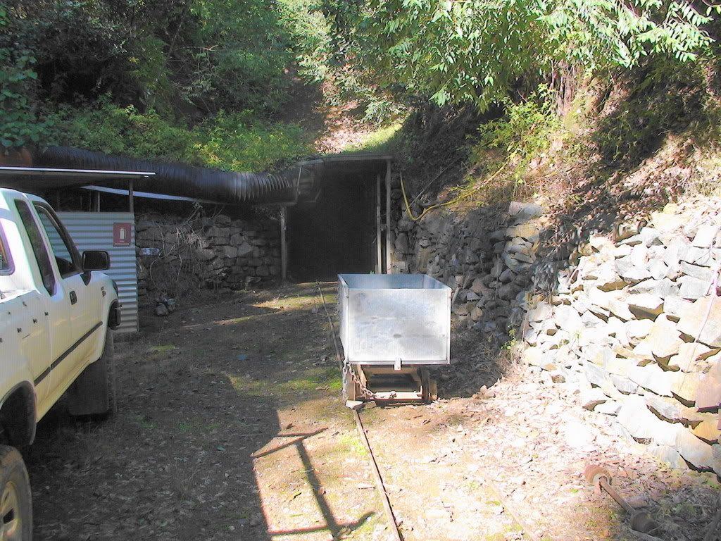

Done a blast on the weekend and advanced the face by 1.8 mtr, now Ive got about 30 ton of rock to load and tram out. Crushed a buket of vein material for a sample but alas no gold. These narrow reefs can be very patchy, in some places in the old workings they were getting crushings of 100 oz to the ton, Id like some of that. Here a few more photos of our entertainment area ,sampling jaw crusher and ball mill and portal ,

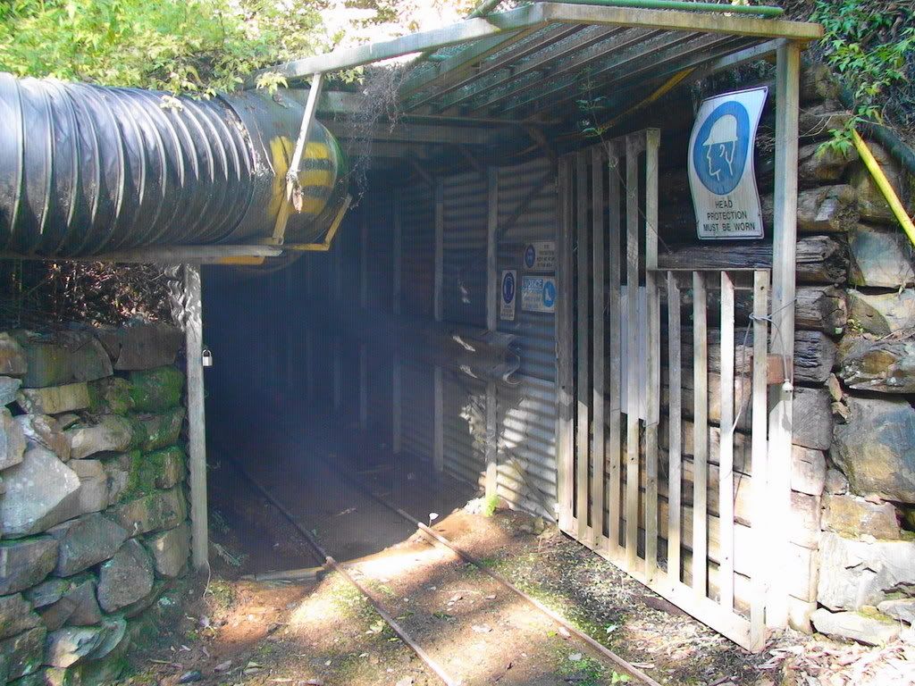

Question:Last 2 pics look like you are blowing air to the face rather than exhaust ventilating.Is that accurate or just vapor haze at the pitmouth?

Yeah were blowing air to the face which is 500mts inbye. The haze at the portal is the last of the fumes after a blast.

Curiosity on my part,no armchair quarterbacking:How come you are blowing blast residue and dust down your main entry instead of using negative ventilation?
Coal seams I worked we needed all the intake air we could get to dissipate methane and carry float dust away from workers.I still ended up rocked up to 45% of lung capacity.
Your adventure is one I would still sign on for.Nobody lives for ever.

You can blow air to the face using layflat plastic tube hung from the roof,to draw air from the face would require solid duct such as fibreglass or metal which is considerably more expensive. The old timers had considerable ventilation problems in 1882 , they tried to excavate a ventilation shaft to the surface about 200 meters along the tunnel from the portal, this shaft would have needed to be about 180 feet straight up, they made it about 100 feet.
