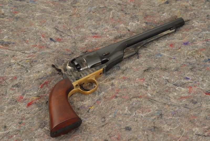

Here is my Uberti 1860 army clone. Its a hoot to shoot, and suprisingly accurate.

Here is my Uberti 1860 army. Its a hoot to shoot, and suprisingly accurate.
Great find!

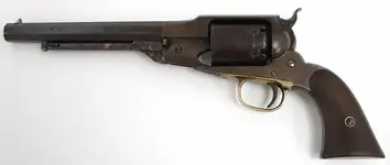

I'll add a couple pix, an 1858 Beals New Navy triggerguard and the pistol it came from.

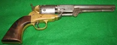

wag, 1851 colt copy made for southern troops in .36 cal
or it could be any from any number of pistols of that era that were part brass.
im kinda thinkin that the trigger guard was at one point, more round but could have been damaged in battle or even
by a plow years after.
