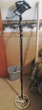

I see the puck pictured in the waterproof water kit.
Where is the phone jack on the puck i can`t find it ?
Gary
Gary
You have to add a third party phone jack adaptor that slips onto the puck rails. You can buy one at detector stores that carry Deus accessories, at Amz, or on eBay for $10 to $20.
No problem. Personally, I think it should be included as a required accessory for the WS4 but I am not sure if XP makes it or not.
