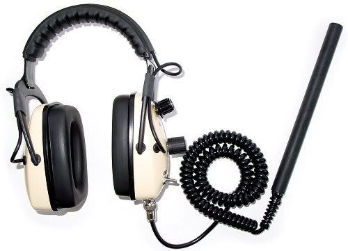

I use the detectorpro Uniprobe, you will not find a better probe, a little expensive, but worth every dime. It easily detects 4+ inches deep. I bought mine used at a great price, $220. I have used it by itself to hunt under metal bleachers and metal monkey bars where I could not swing my detector.
http://www.detectorpro.com/uniprobe.htm
Now when combined with the EZ-Dig-R system, I can recover a target and when done leave no sign I was ever there digging.
EZDigR Ststem
