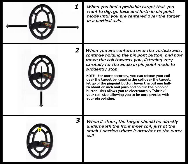

I'm having a heck of a time pin-pointing targets with my Ace 250. I recently down-sized from my White's XLT due to the economy and I'm used to the XLT being dead on when pin-pointing. My Ace has me looking everywhere around the hole causing me to dig a bigger hole then intended. Anyone else have problems? >:(

Here's a pictoral method od pointing off the front inner toe.
John's pictures are dead on. I would say 95%+ of the targets are right where he shows. Combine his pictures and my video and you'll be an expert at pinpointing. Throw in a Garrett Propointer and there's no stopping you!
I have had a few times with Foil or a odd target thats pretty deep showing the point pointer in the wrong area. It just takes a 90 Degree turn and it normaly fixes it.
