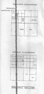

They did make it difficult because they have quartered off 1 giant plot into 1/4s. But if you look how I have it wrote out it will help you understand what they have done. Each quarter has it's own nw, sw, ne, se. The nwnw is the northwest corner of northwest plot, the southwest corner of northeast plot and so on. 20200203_124544.webp

Four blocks of four squares each. The prefix is where in the 2x2 section the individual square is.
Prefix NW (North West) Suffix NW (North West) is the upper left corner. Beside that is NE (North East) of the NW (North West) grid section.
So each square is 40 acres.

But your 16 squares are one section. So one quarter section would be any four squares. The "NE" quarter section would be the squares labeled "NWNE+NENE+SWNE+SENE"

Looks like you have 1 square mile (640 acs.) in the total picture area. Next, divide 640 by 16 squares = those are 40 acs. each.
That diagonal piece is someone who cut that out of the original area for whatever reason to drill/prospect/mine, ect. and has a separate description assigned to it.

Jon 8-) :cat: :occasion14: :headbang: sections.webp typical_section.webp
