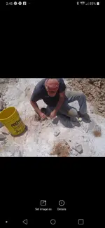

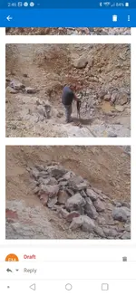

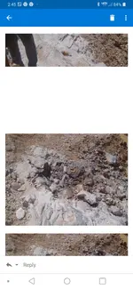

I wanted to show the difference in the reduction of stone from the quarry to a preform. The 1st two photos are what was made in the quarry by NA. 0822191412.webp0822191412a.webp This is not a axe or chopper. This is the shape and size made to be carried out of the quarry. The next few photos show pieces that were reduced to a smaller more transportable item.0822191412b.webp0822191412c.webp0822191412d.webp0822191412e.webp This was then traded and made into preforms like these.0822191415b.webp0822191416a.webp. I base this information from a NA quarry that I found and started mining my self. We found large spalls on the mountain and in the valley below we found small worked items at a camp site. Not blowing my horn but I have mined tons of stone.Screenshot_20190823-024608.webpFirst we had to remove overburden with the big toy. While doing this we have found hammer stones as big as bowling balls.Screenshot_20190823-024545.webpThen after drilling 1in holes 4ft deep I would set charges of black powder, dynamite is to hard on the stone, to much of a shock wave.Screenshot_20190823-024559.webp This photo is after the blast and then we would end up with about 3 tons of stone to be spalled down to fit in 5gal buckets for transportation.Screenshot_20190823-024615.webp We moved over 10 to 20 tons of dirt and stone to get to the perfect materials, I can't imagine how hard it was for the NA to quarry with sticks, rocks and fire.

Reuellis you are very correct on that, because where I live there are only river cobbles of chert that was brought down my ancient rivers from glaciers. The NA would dig into the old river beds just to find fist size stone. Where I quarried was in the Ozark MT
of Ar. where good lithic stone is not much problem to find. When lithic stone was hard to get and they didn't have a steady trade system set up, they used everything they had almost.
