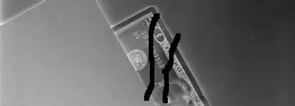

tried it ,
could scan onto the screen the first quarter
but wouldn't let me scan to save

could do top quarters
not bottom quarters.
color converted after
