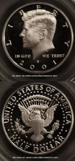

Top picture- Regular business strike half dollar
Bottom picture- Proof half dollar.
