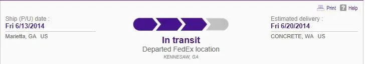

Yeah, the stuff i have is 3/16" holes punch plate. oh well, if anyone need some let me know.
Seems its on its way and you can have it by friday!
