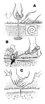

what state u in? doubt other states are that much different, but in pennsylvania, my home, u may dig in state parks, but with nothing larger than an ice pick. actually, better- lemme give you the official words:
from the FEDERATION OF METAL DETECTOR AND ARCHAEOLOGICAL CLUBS website:
see the full site(it is LOADED with info should answer ur ?s PERFECTLY)>>>>>>>>>>>>Federation of Metal Detector & Archaeological Clubs Inc.
i'd get a probe (or long electricians screwdriver w/ end filed down a little bit as to avoid scratching your target). follow this diagram for how to use it:
good luck
happy hunting:laughing7:

By all means, get a pin pointer. Check out some of the youtube videos on how to do a clean recovery. I agree with Msbeepbeep, practice in your own yard first and use plug cutting as a last resort. Probe first, slit second, and a three sided plug third. NO FULL CIRCLE PLUGS!

I was just in a park today with a well manicured lawn with an irrigation system. For 90% of my targets my retrieval method was:
1. Pinpointed the target with my detector
2. Used my Garrett Pro Pointer to precisely pinpoint the target
3. Used a brass probe to quickly find the item, if not to retrieve it as well if shallow enough
4. Pushed in a screwdriver next to the target it to pop out the item
This method leaves no damage and does not attract attention. A few deeper items I had to cut a small slit in the sod and poke around to find them. Any loose dirt that I pull out is placed in a old piece of cloth. When I find the target I use the cloth to put the loose dirt back into the slit, then a light stomp with my foot to finish it off. You can never tell that i was ever there.
