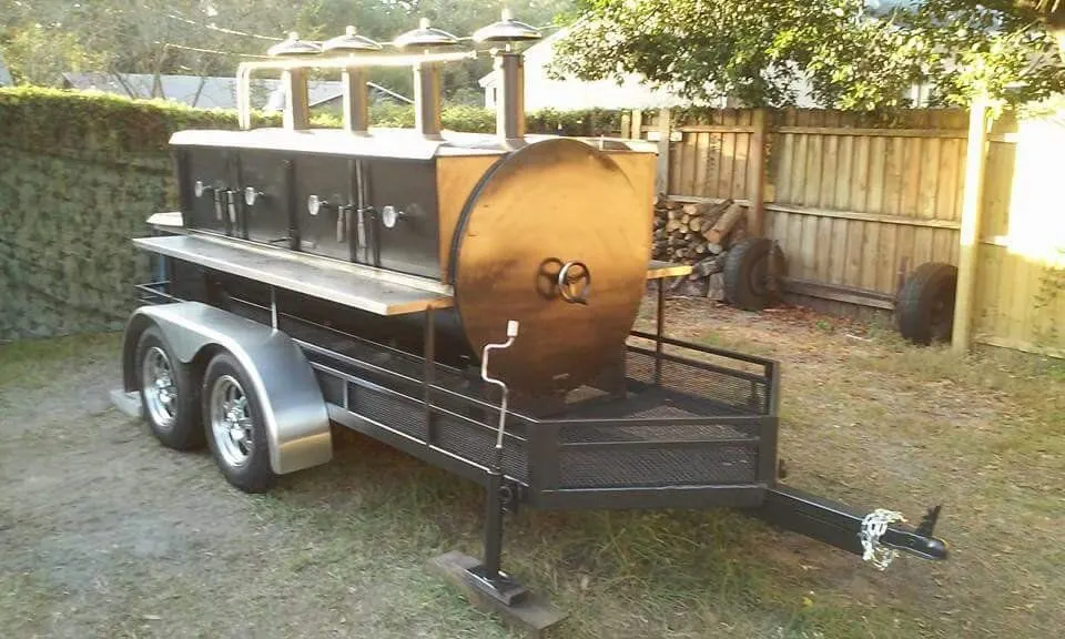

Its time for me to enjoy one of my other inventions...
It only took me 5 years to build it...it has 128 sq ft of racks..doors on both sides..its all double and triple wall steel with 2000 degree ceramic insulation between the layers..
It weighs about 10,000 lbs and runs on oak and assorted other hardwoods..
Happy 4th of July....
Time to get cooking..

Wow !! Nice grill urban. How bout a drone design that acts like a sand dollar or sea biscuit ? Senses a target in the surf zone and then burrows itself into the sand to retrieve or identify the target. It could travel under the sand just below the turbulent zone and then it could inflate itself with co2 and float to the surface with retrieved data or target. There it could be retrieved by surface vehicles or washed to the beach to be recovered. There would be very little disturbance to the surrounding ecosystem. Just my imagination running wild !! It takes imagination to think it up, engineers to design it and investors to finance it. Sometimes innovation sounds ridiculous in the beginning. Im sure the wright brothers were thought to be nuts in there day.

Bart.....ideas are the seeds of invention....
My smoker started on a cocktail napkin...followed by 6 months of researching what everyone else had...and learning the dangers of using ceramic insulation... ( it holds heat so well that it can mangle a firebox and smoker )...then it took another 2 1/2 years to kinda get it where I wanted it...and another 2 years to make it work on its own....
Its a reverse flow system that is my own design... And I had problems making it pull air and make even heat ....it uses a natural draft ..no fans or electronics or gas...just light the wood...bring it up to temp...and cook all day...and night....

Oh man....is my mouth watering !! Awsome design with that monster grill. Im going to a bbq right now. Man that pic is making me starving.

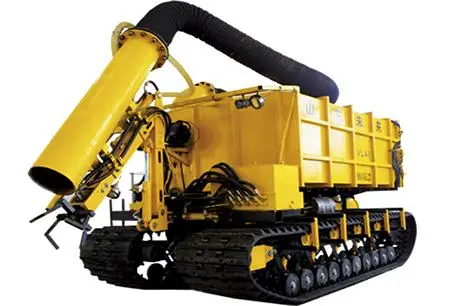

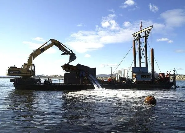

If it were not for the archaeological, cultural and sea life aspects, this would be a great equipment setup to use.

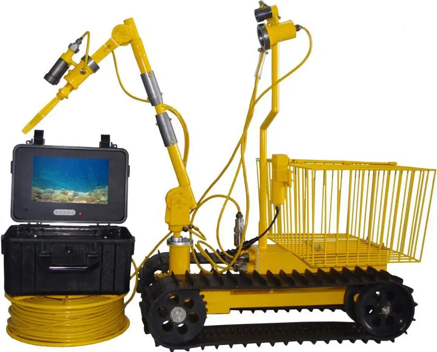

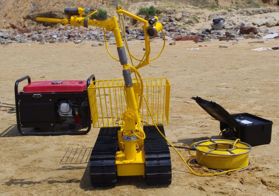

Something this size would be manageable in the surfzone..
