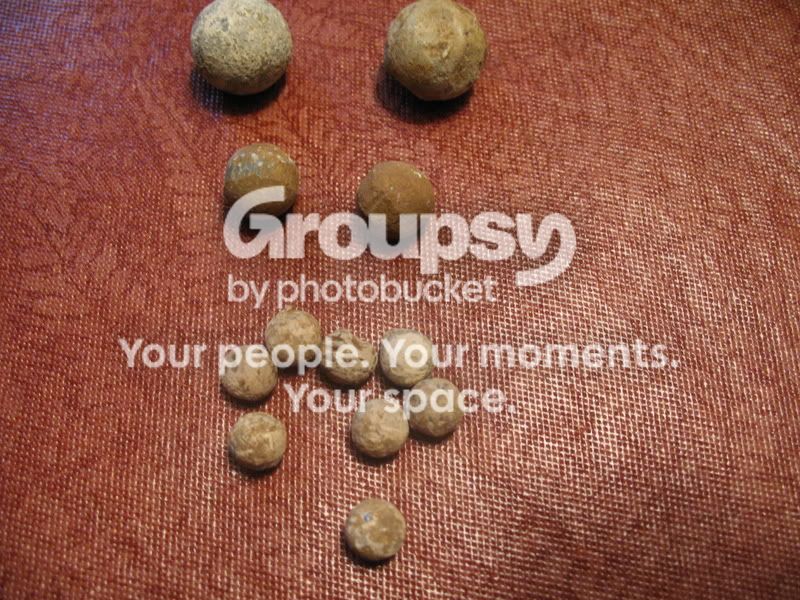

The four on top were all drops, as was the buck ball on the bottom. The other is a fired bullet, and fired percussion cap.
This bullet was fired, but remains in pretty solid shape.
The two .44 balls in the second row also show rifling groves, but remain in pretty secent shape.
