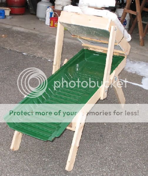

I just put a highbanker together using my Le Trap sluice. Still have a few mods to finish it up. Not a recirc, but going to use a small motor and clear water pump. Now, just need some warm weather!
patch, i like that frame too. nice rig. if that will handle a 2.5 " ------that's not too bad , not too bad at all ! lookin , does yours do good ?
