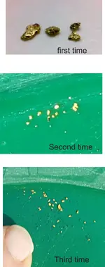

Here is my sniper (30 inch model)
Yes. the gold in my area is tiny! usually only -100s. In the blue pan pic, thats some of the biggest gold i have ever seen in Villa Rica.
Sniper model - 24" and 30"
First run was with the 24"
The following two trips was with the 30"
And all this really shows is that I need to get out more.:BangHead:
That's incredible! Did you find the upgrade (30") worthy of the difference from the 24"?
Sorry my mistake, mine is the 30"
I would say yes - I do notice a little difference.
I feel this is most noticeable when water flow is fairly slow.
I think the added length helps with boosting velocity in the fluid chamber as well as on the top deck.
And I can still get the unit in my backpack and fully covered up.
Cheers
G
