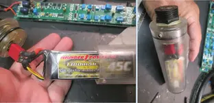

Yes I have been using one for almost 4 years now and it still has a killer punch, I went for the EX3000 for it is alot cheaper then the one I have been using and I wanted a back up..
One thing you HAVE to check is that the charger to battery pack adapter is good.
I had one go bad where the internal solder joint broke loose from the center pin and one where the screw inside the connector that holds the other end of the internal wire came loose. Both conditions caused what I first thought was a battery failure. Both were only a 5 minute fix. Just make sure you do not put the adapter back together with the locating screw in in the wrong position. Mark the adapter well and write the info down so you do not forget how to reassemble the adapter. When taking anything apart I find it useful to take photos as I disassemble anything! The photos have been their worth in gold. With today's smartphones and digital cameras there is no cost as there was back in the day of the Brownie 126 film camera or the Polaroid camera. Snap on...
