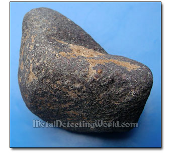

This has a write up but I don't know if it's a comprehensive list, I think there's a lot of potential offenders here
