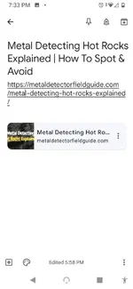

I don't know how to send the link but just type it in I box.its got some good info.
