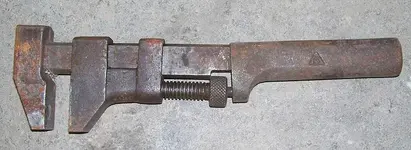

That might not be a hammer, could be part of a monkey wrench.

I think your right mick
Thanks but it is not part of a monkey wrench. I have found exact examples of the hammer that i have on line and they have been called a picket line hammer or an artillery hammer.
JimK
People can call it whatever they want to.
