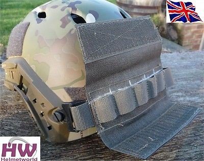

Light batteries are in the lightd and they are factory sealed, can't be removed.... maybe I will put a scuba weight pocket, or I see that they are counterweights for Army helmets (counterweight for the night vision binoculars).
I used a roll of dimes for my counterweight on the NVG's, but that wasn't dealing with buoyancy issues, and if it came to that, I had bigger problems.
