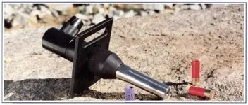

Ok, I just stopped by a thread I hadn't been following and found this post by Red James cash. Actually, at lunch I went and looked at Home Depot to see if you could even buy the Ramset cartridges anymore and was impressed by how little the guns weighed. Naturally, they're only firing nails into wood or concrete, but I was expecting a bit more mass. I'm less leery of the entire operation and having seen this from Red's post, it seems you could either get this, or build a system yourself.
ezebreak - Makers of Micro-Blaster, a compact and affordable system to crack rock and masonry, is safe and easy to use.
Found this thread over on gpex.ca
eze break micro blaster
Where someone linked a 12g shotgun shell system
Boulder Buster: Solution for Breaking Rock, Boulders & Concrete
And that gpex thread had this doc as an attachment
Warning - PDF
A COMPARISON OF NON-EXPLOSIVE ROCK BREAKING TECHNIQUES.pdf

- Capping method to remove smaller chunks with shallower holes. This is if you are sneaking up on random pockets. Much like this micro-blaster video
Keeping in mind that microblaster charge is like 2" long. Even the ball busting shot was 2 caps. That in the cave boulder shot was only 1 cap.
