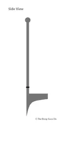

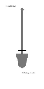

Digging in the grass without leaving a trace, or much of one, takes some practice. Even then, depending on the grass type, density, soil type, moisture content, etc., making a nice plug can be difficult and sometimes impossible. Sometimes putting the dirt back nicely is all you can do. Always use the best method and tool available, especially in manicured lawns.
No single digging implement can cover all the bases. With that said, we all have fields filled with pull-tabs with gold potentially lurking therein. It would be nice if there was something that could make a decent plug (depending on conditions) and excavate most of the hole with one action. Then you would just have to kneel down, possibly with pinpointer, and find/extricate the target.
I've thought about a shovel like this for some time. The field I'm hitting (again) has the old ring pulls - about 1/3 with beaver tails that I can usually spot. But, the ring pulls themselves have to be dug because they are right in the gold ring range. They are about 4.5" down so I use depth to discriminate as well.
I want to dig a lot of them in a shorter period of time without as much effort - something we all would like, no doubt.
I have no idea if this would work in the field - it might even exist now - I don't know. Basic principle is shovel with built-in U-Plug Cutter. Have thought of various design enhancements, etc., but this is the basic idea. I thought I'd throw this out there to see if anyone has seen something like this or has additional ideas.

Thanks 460!! Much appreciated!! Doubt I'd ever manufacturer it...too few detectorists in the market to make it worth it, imo. Might talk to a welder/designer and see what they say - was thinking of starting with a 4" to 6" steel pipe cut in half with the sides extended and you go from there. Would make it with flowing lines and curves for support - lots of pressure on the tips of the U-Plug cutter portion. Scalloped, sharp edges on the cutter/blade.

One last piece not included in the drawing:
The problem with the physics of this blade is the large (long) blade edge, or surface area. This will make it harder to push into the ground.
It would have to have a rather large platform for your foot - you could then do a "gravity plunge" by standing on the platform and using your weight - a lot less effort than trying to force it with your hands and a little foot step.
