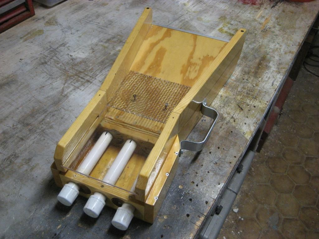

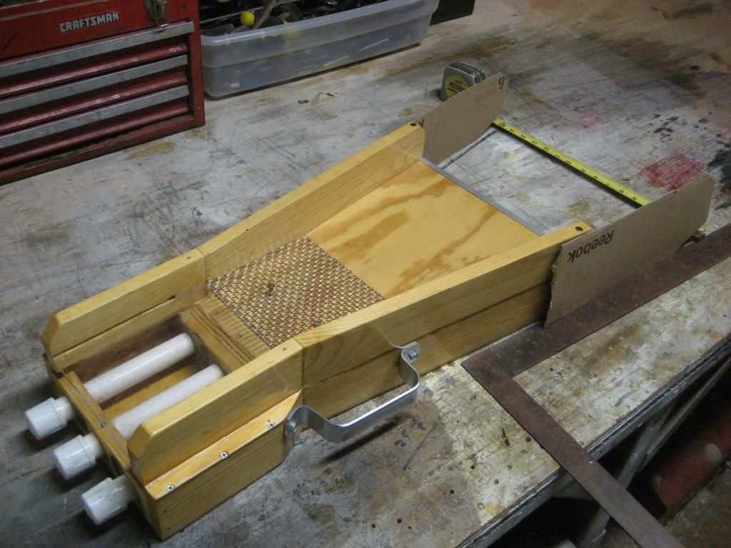

Goodguy,
I would like to put side slide extensions on my 24" sluice which will increase the opening from 11" to 16". They would be of aluminum and slide towards the rear, extending about 11". Does the winged opening, without the bottom, increase the velocity, pressure, or volume going towards the tubes and over the slick plate? You have already experimented with this so the expertise is in your court. It should direct the flow but how much and is it worth the effort?
Thanks,
Mike
Goodguy,
Thanks,
Mike
Not worth the effort in my opinion. I took mine off.
GG~
With the size of those wings it's hard to believe that there wasn't a lot more water running through your fluid bed. Oh well, I'll can this idea.
Thanks,
Mike
Thanks,
Mike
The wings worked great in certain situations where the water level was the right depth so that the unit could sit on the very bottom of the creek bed in order to keep any flow from going underneath the wings and provided the flow was fast enough so that the sluice could run fairly flat. In deeper water or especially where the sluice needed more angle due to too slow flow the wings were pretty much useless if they were sticking up out of the water due to the steep angle.
Because of seldom having the ideal situation I removed the fold out wings in order to save weight.
GG~
Thanks, I was trying to get my head around not having a bottom to trap the water escape. If you have a drop then the water can get around without effort because the wings actually lift off the stream bed. I can't remember whether it was you that had the aluminum drop-down with a bottom. That sounds like a killer idea! Anyway ....... thanks for the input. I used my fluid bed this past summer and killed the gold. I was impressed but came home and removed the two 1" tubes and changed them to three 3/4" with a more even distribution. Now I have 5/8" spacing at the sides and 1 1/4" between the middle. Kept the alternating pattern the same with 1/8" holes and now I'm done. Improvement for the 24" fluid bed design with a wider bed than slick plate to slow the exit flow minutely. :-)
Thanks for your time,
Mike
Mike
Your sluice looks Great!
And your fine tuning resulting in a more even stratification of material in the trap is quite an improvement.
The adjustable scoop that I installed on mine certainly does come in pretty handy sometimes.
Thanks for the compliment.
GG~
