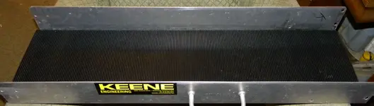

Keene A52 with V-matting. Doug Watson mentioned they were using V-mat on the Washington beaches and having some success.
I can put the expanded metal and riffles over the V-mat, no need for the carpet.

Just run the V mat or vortex mat all by itself no need for the expanded metal or riffles on the beach.

I am considering using a piece of vortex mat that I use in a hi banker for mat in a beach box. It is 12" x 48" and my question is what are the opinions of you guys as to how much slick plate, if any, should I start with
? I don't have the box built yet so I'm starting from scratch. I also have ribbed mat that I could use or interchange. The creeks running into the ocean have a good flow right now and that is where I want to set up. I'm in Oregon so have to consider the no motor BS. Thanks in advance for any input.

To get proper exchange with vortex mat, it has to be running at 15 degrees...really tough to do in a stream!

From what I have read on this and other forums, the consensus opinion is that it is best to use ribbed mat in stream sluices for beach sand where motors, etc. are not allowed. A fairly long slick plate with a smooth transition to the mat will allow the gold to better classify and settle prior to entering the mat section.
I am experimenting with goldhog mats but I did not have ideal stream flow in the one time I ran it. I did catch gold though and intend to do further testing this coming summer, conditions permitting. I also have run a homemade magnetic sluice (very much the same as a Cleangold sluice which is reputed by some to be the best for the mostly minus 100 and much smaller mesh Oregon beach gold) a few times with success. The Cleangold is pooh poohed by some/many (they are not owners and seem not to know how the sluice actually works) but it does work well. One problem is that virtually all of the concentrates collected by the Cleangold method is tiny, heavy magnetic black sand and is extremely difficult to pan. There is an unpublished/secret method on how to more or less solve this problem and is only revealed to purchasers of the product which seems to lead to most of the skepticism.

Thanks for the input, guys. I'll start with the ribbed mat and see what I can come up with.
