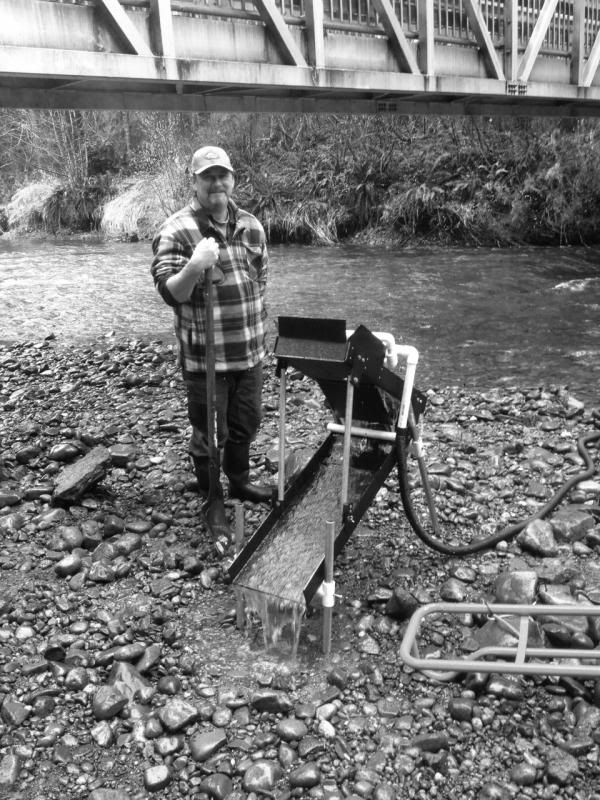

Here is the Super Mini on the SF American today. Had a jam up in the grizzlies from force feeding it at the same time that I saw this flake. Grabbed the box out of the water, got the flake stuck to my finger and got the snuffer cap off. Somewhere between my finger and the snuffer the flake disappeared never to be seen again. I call it catch and release. Other than that the BGT did what it is supposed to do.

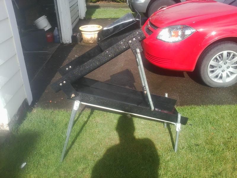

My homemade highbanker.
3/16 screen dropping onto 1' x 3' vortex mat. If it hits the mat, it stays until clean out. Hold everything from 1/8" down to minus flypoop.

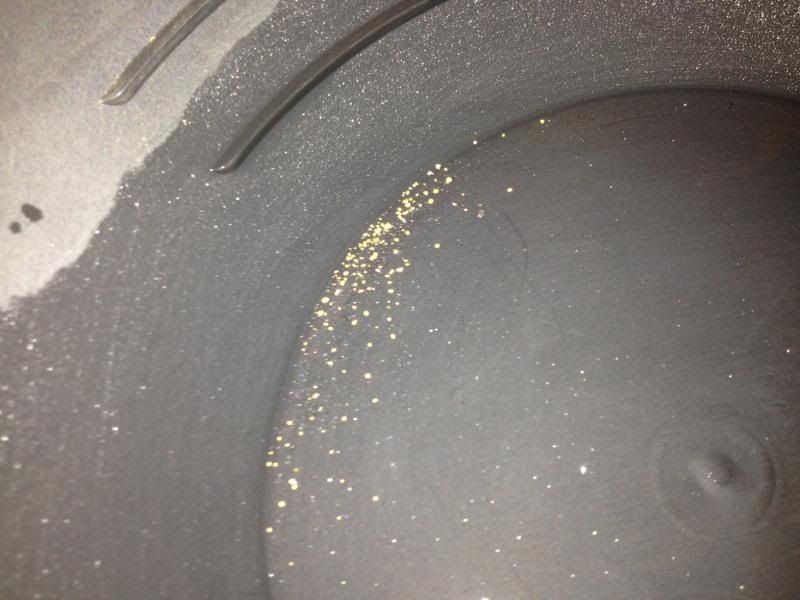

Last weeks take from 4hrs digging...
Wow, really pro looking...good work!
I can show you how to easily modify a few rows of the vortex mat to catch up to 3/8" nuggets.
(PM me)
