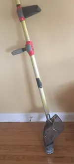

Here's mine. One-handed operation. Never have to bend over, stoop over, or have 2-hands on the rod/pole. Your 2nd hand stays with your detector.
and here it is in actual usage :
I would suggest a wood handle from Home depot, Lowes or any store like that. It should cost less than $20. Carefully fit the wood into the scoop part, you want it to be snug with no play in it if you can. you want the grain of the wood facing front to back, by that I'm saying in line with the metal basket. It will keep it stronger with less bending in the shaft. one last thing, try to cut the end of the wood that goes into the scoop on a matching angle so it goes as deep into the tube on the scoop as possible, then add the screw to hold them together. If you look at my picture the lower handle has a "Grip" on it, you might not need one but if you do...that's a grip from an old set of crutches, it works great and that one has been used for over 100 hours and still going strong. Another plus with these grips are the placement of the upper one lets me push the shaft further away from me letting the scoop go almost straight down into the ground. You can put these grips anywhere you want on the shaft, you can use one or both if you want. It took me a few hunts before I had them adjusted where I liked them. they fit different size shafts. And you might want to price the fiberglass/Carbon fiber shafts, you can buy a lot of wood shafts for what one of those cost. any more questions contact me and Ill do my best.
