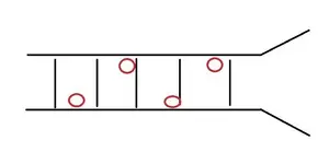

Have you considered trying something like the image below, using rocks
(red circles) to create somewhat the same conditions in a straight sluice?
the problem is it creates uneven scouring and gives places for material to build up.
The flow would also have to be minimal for rocks to stay in place.
Large ops tried all kinds of recovery designs from the late 19th to early 20th century. There have been sluice runs with staggered baffles.
There is a reason that the industry settled on expanded metal over burlap ,carpet, miners moss etc.
it worked better than other recovery designs.
