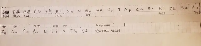

Hello all, here are XRF Scan results if someone can help point me in the right direction. LE% is for the Light Elements. Thank you for the help,

stdenis_jd
May 7, 2015
513
576
West Lower Peninsula, MI
Prospecting
Looks like a phyllite/schist to me, but with the the lighting is impossible to tell. Can you take a picture in natural light? Looks like you took the pic indoors with flash which obscures almost all of the details.
