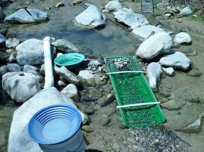

How do you feed your sluice? Do you classify? Or feed straight material?
I am sort of inbetween. I set the bottom of a metal shopping cart at the head of the sluice, and set a 1/2" classifier on top. Then feed the raw material onto the classifier. I hate, repeat, hate having to handle the material twice. In the picture, I am just using the bottom of the shopping cart to screen out the big rocks.

Assuming your sluice design is set up to accept non-classified material, it then depends on your sluice model, water flow (velocity), and pitch of sluice. Goldfleks photo above shows her Bazooka sluice set up with water ripping across the top plate. I'm sure that any roundish rocks smaller than 3-4 inches in size are clearing her sluice easily.
In the photo below (36" Bazooka Sniper), I had OK flow, but any rocks over 2.5" or so were hanging up on the grizzlies, so I was hand-classifying out the larger rock.
In the image below, the flow on this little creek was so slow that even with my makeshift tarp dam across the entire width, I was barely about to get enough flow to run the Gold Hog stream sluice - classified down to 1/4" classifier. This is the other end of the spectrum from the flow shown in Goldfleks and my Bazooka photos.
If you have reasonable water velocity, and your sluice model does not require classifying, then feed it whatever it will take. With moderate to low flow conditions, set up and tune the sluice as best as you can (may require wing dams to divert flow), and then test the feed with unclassified material. If your not getting the exchanged needed to capture gold, try classifying to 1/2" and test again. If needed, go to 1/4" classifier. I have not gone below 1/4" classifier, but some folks have needed to go down to 1/8". Good luck and heavy pans!
