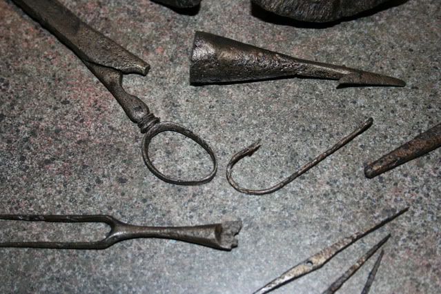

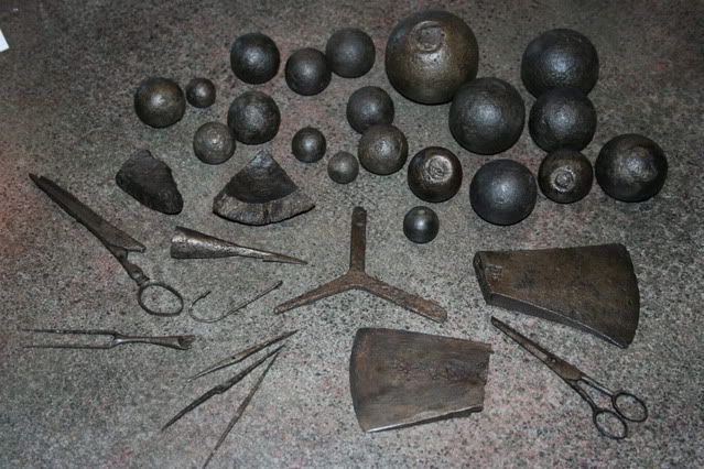

I thought I posted these at one time but I can not recall. I do know some folks attempted to contact me with some questions about electrolysis, but I was unable to get back to them and no longer have the messages. My apologies, and feel free to pm me if you still require some help.

I have been using electrolysis over the winter on some of my iron 'thingies'. But, I can assure you that my results are not even in the same neighborhood as yours. You did an amazing job !!!!!
Do you coat the items with anything when done to preserve them?
Great job and pics !!!
Brian
Thanks Brian. It takes a heck of a lot of work. Not as simple as dropping into a bucket and letting it do it's thing. It takes some elbow grease prior to electrolysis as well as after. I use Briwax to coat my items. Works great. The important part to remember is to get every bit of rust off. If you don't, you can coat it with anything you like...and the rust WILL come back.
