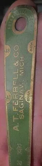

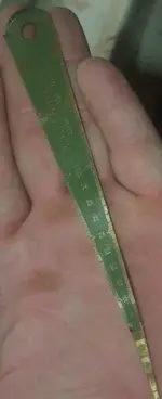

Some sorta pointy ruler?
mojjax
Feb 27, 2005
4,564
4,092
MAINE
Ace 250
I think we're making progress here ... but please be reminded that any "screen" hole much larger than a grain of rice just wouldn't make sense. There is no grain seed in the world that I know of that is 3/4" long or wide. :icon_scratch: But I will go along with the "possible" measurement for some kind of opening.

Not just for grain but for seed for farming could be beans or other large seed.
One thing for sure its not Metric. 64ths of an inch looks to be correct.
SODABOTTLEBOB said:
P.S. ~
I forgot to mention that ... 22 millimeters = 0.866141 inch :icon_scratch:
0.866 is approx. 8/10ths of an inch which is over 3/4 so it cannot possibly be Metric. The scale has 3/4 (0.750 inch) as 48.

taz42o said:
The numbers are 64ths. 40/64=5/8 ,48/64=3/4.
Round hole screens are often designated by a single number such as 10. This means the screen is 10/64ths of an inch in diameter.
I would guess its for measuring screens in air screen cleaners for seeds.
taz42o ~
I just wanted to acknowledge your contribution. Your seemingly knowledgeable "guess" is what led me to finding the necessary "proof" to establish that Mojjax's item is a measuring device for determing the size of holes in the various seed cleaning screens. Good job! :icon_thumleft:
And Big Cy, too. He was right about it not being metric, and I was wrong. Good job! :icon_thumleft:

Maybe it's a dipstick for oil/fluid measuring? :dontknow:
Taz got it! I was racking my poor brain trying to connect 5/8 to 40. I knew it is a bore guage, the markings were not familier. Good Job.
Hopefully by now most of you have had time to read through the manual I posted a link to. But even if you haven't, the picture of the chart should be sufficent enough to support the following. But before getting into that, first I would like to point out that Mojjax's "calibrator" "gauge" (or whatever the exact term for it might be) appears to be of a universal size which covers screen measurements larger than the model of seed cleaner refered to in the manual.
Based on the corresponding numbers on the gauge and those on the chart, I am confident all will agree that they match close enough (if not precisely) to confirm that the two are obviously related. Meaning that Mojjax's gauge was designed for the specific purpose of measuring and determining the various size holes in the screens.
