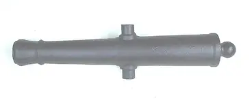

It sure looks like a cannon barrel, but it's lacking trunnions, even for a swivel gun, it needs trunnions to hold it in place.
If it is a barrel the trunnions could be in the missing sections. But in that case there should be a touchhole left in the breech section.

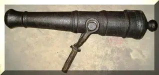

Yeah, I got to thinking about that after I posted. For those that might not know, here are a couple of pictures showing the trunnions on a cannon barrel. They are the part that is sticking out at an angle to the barrel.
And this is a swivel gun, showing yoke and trunnions.
