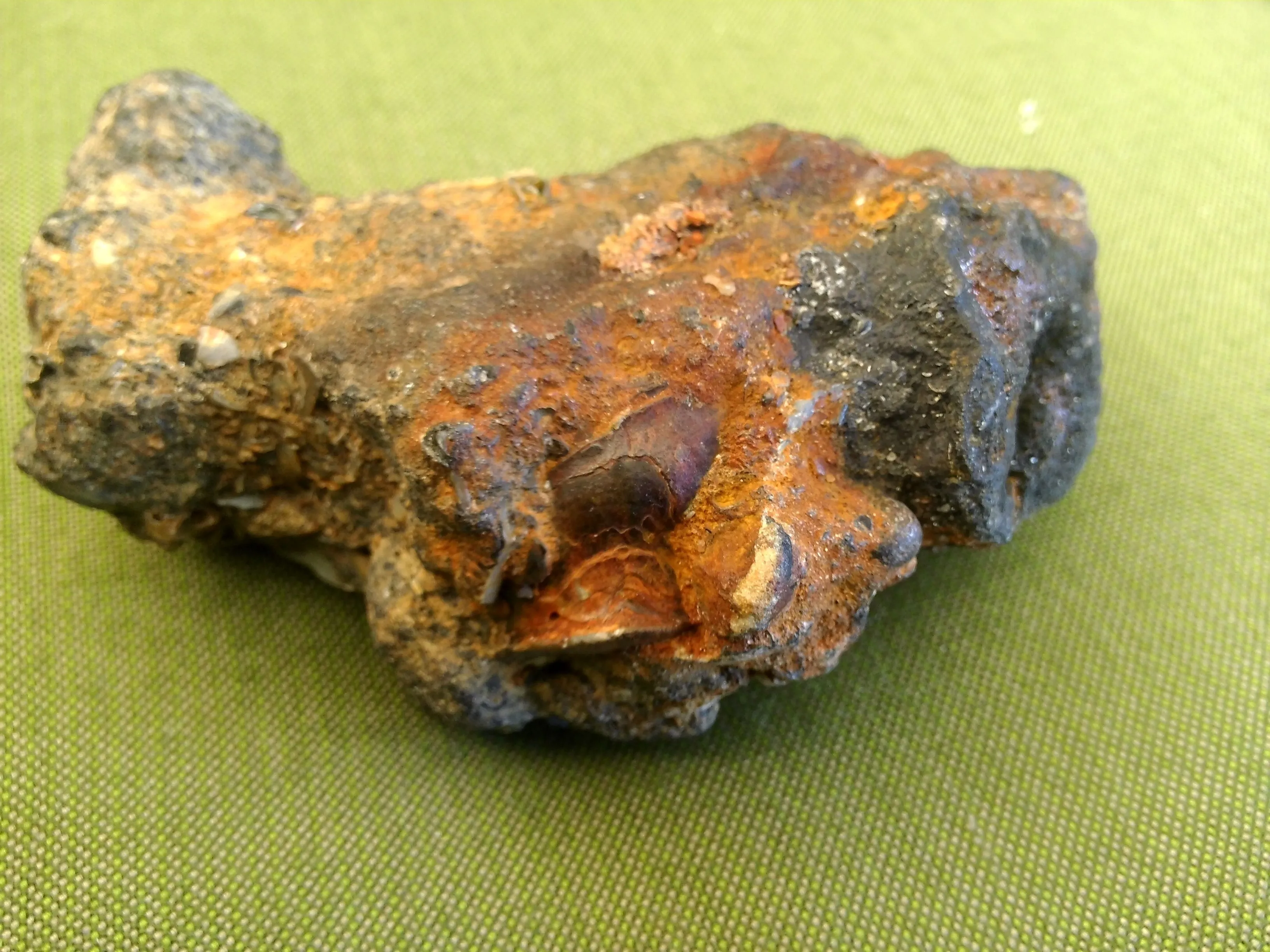

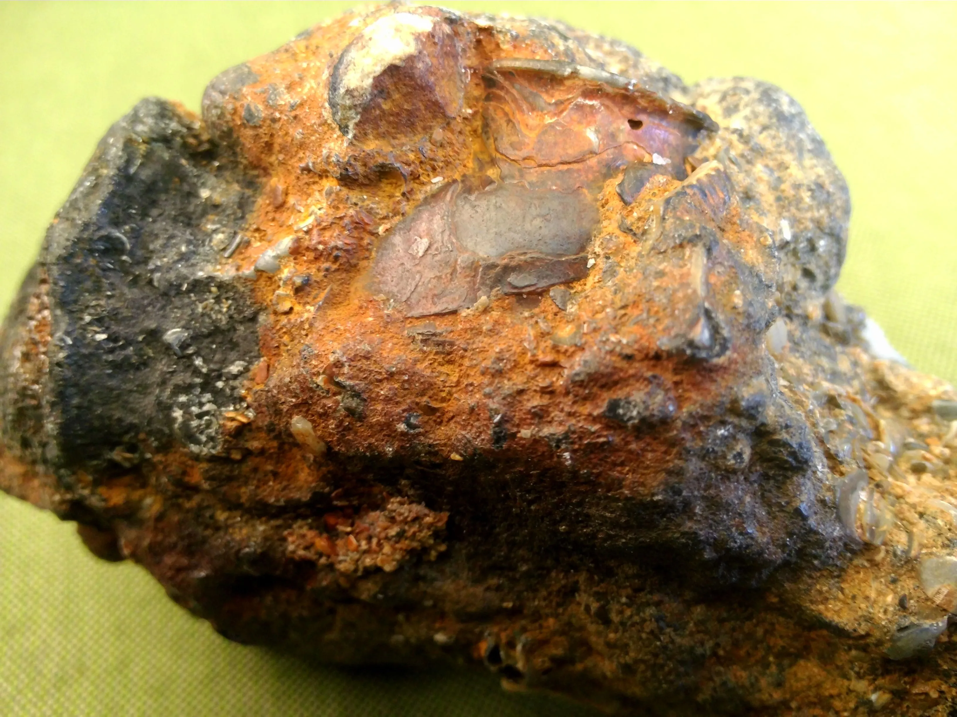

Hi,

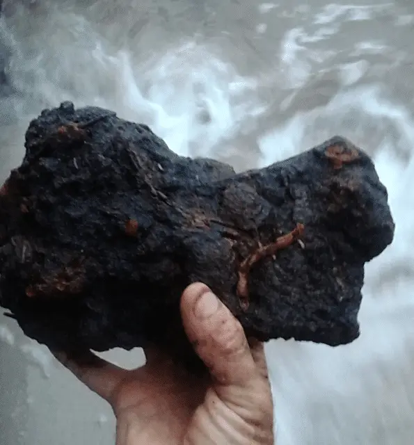

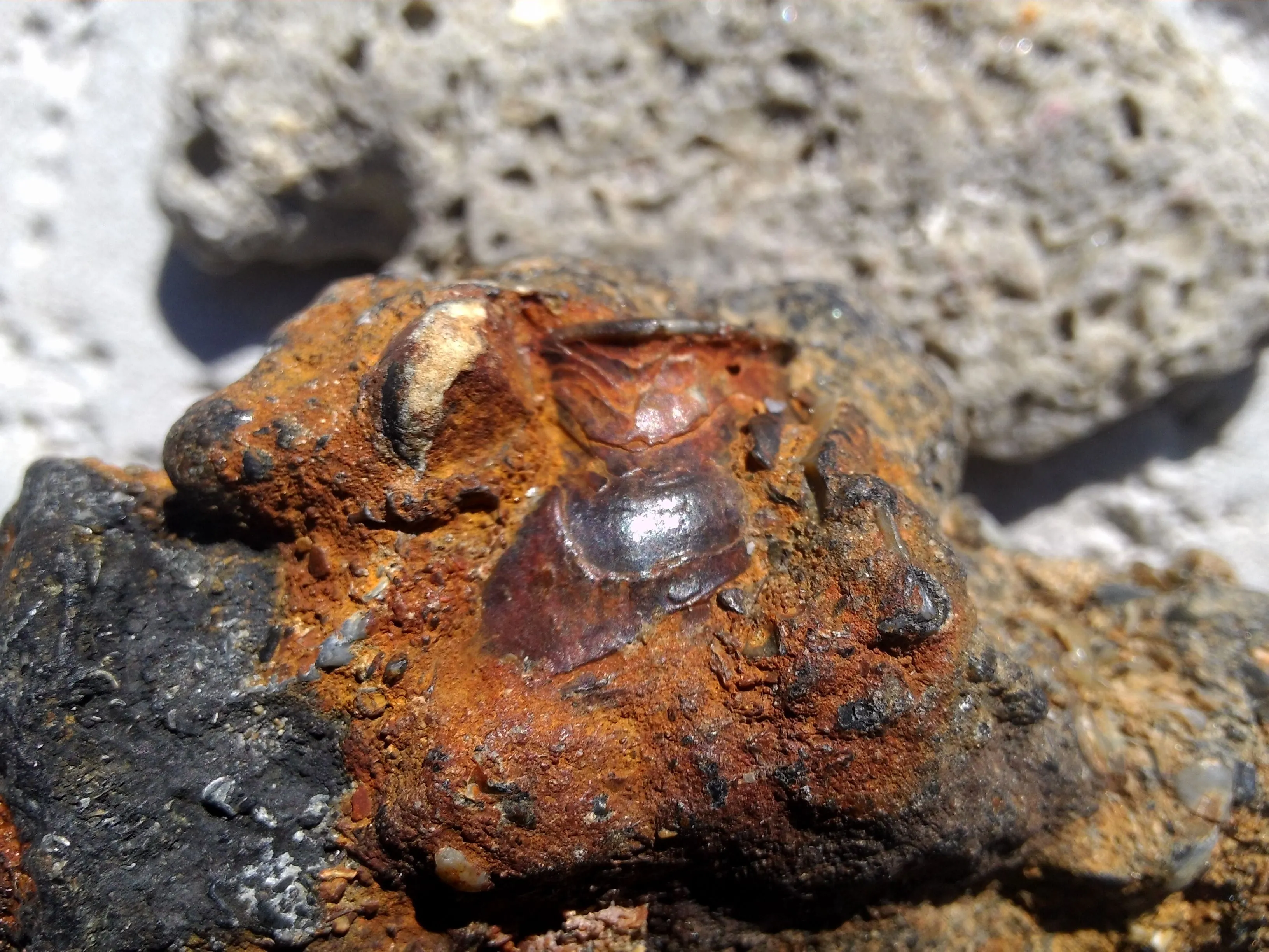

These photo's are of a heavily encrusted clump. (Really solid) the outcropping that looks like a coin (or Small container with a lid) it;s metal.
In fact I can't seem to locate any exposed metal although I get some strong hit's with my pinpointer is several area's of the clump. The overall lenght is just under 5" The (coin/container) looking outcrop is less than an inch long.
Any idea's on how to get to what's inside?
Soak it in plain water, use a small tack hammer to chip at the edges. When you get it down some, do electrolysis.
Does a magnet stick to it?
The first photo shows what looks to be clearly exposed metal there's even a lip on the rim of whatever the elbow shaped piece is.
It kinda does... But just for a moment let's figure there's something good in there there may be several things the last thing you want to do is have a hammer and chisel anywhere near it..... If nothing else put the entire object in a diluted acid water mixture.
Personally I would start with the coin looking object and wipe CLR on and around.. Wait till it stops fizzing then rub the loosened material away with my thumb and rinsing repeating that process as many times as necessary until I could id the object. If it is silver you could then use any type of silver cleaner to remove the tarnish and get a look at it even while it's still connected to the conglomerate
No magnet and the coin looking thing doesn't set of the MD pinpointer but I get other hits around the surface. Something metal is just below the encrustation at several points. I'm going to try the acid bath you suggested.
Thanks
Good luck..and also..the heavy calcification can make a pinpointer pretty unreliable.
Non specific to say the least... Just from the color I could tell you there's metal content in almost that entire piece.. even if it is from corrosion.
Forget about the pinpointer just look that is metal showing

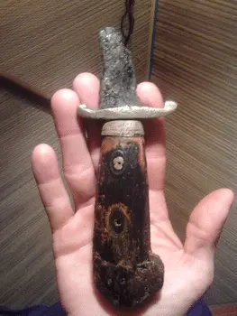

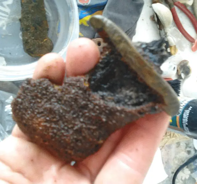

Just want to post at least one thing I've treated to show I've done this before.

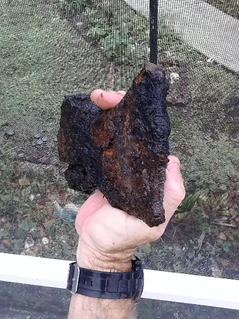

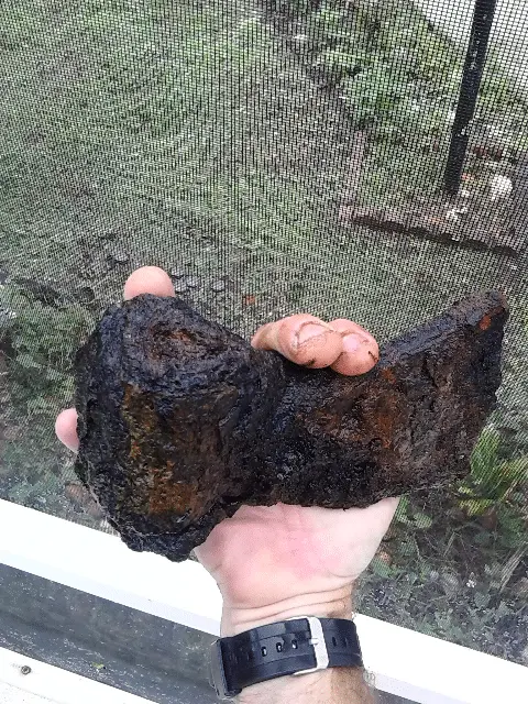

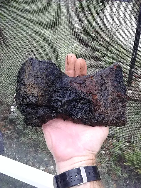

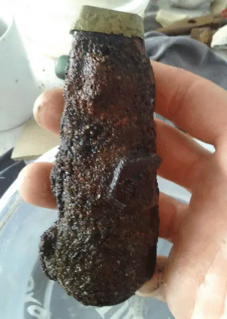

I found a heck of a piece of metal today.. I wasn't expecting to find an axe head..looks...oooold too
GatorBoy said:
I think he figured this out on another thread.. For some reason I remember seeing pieces laid out on a paper towel... Maybe I'm wrong. I found a heck of a piece of metal today.. I wasn't expecting to find an axe head..looks...oooold too
damn it boy! Do show a picture
Its in electrolysis now
Nice ax head, is it striated?
